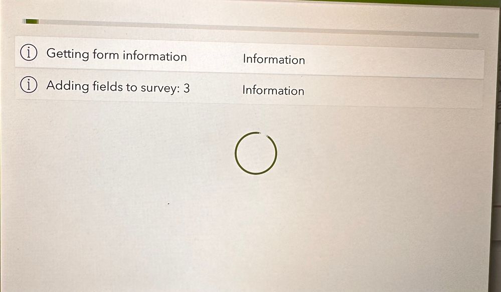

I am getting this constant error when trying to publish the survey. I have looked at previous solutions and it did not work. Can someone help me with this error?

Hi.  I see this message when I add new fields to the XLSForm in Survey123 Connect for a survey I have already published.  Basically, the message is saying during this current publishing step, three new fields have been detected that are not part of the prior published feature service.  Click the 'Add' button if you want to add the fields and make them available in the survey.
SeanRourke
Hi. Thanks for the reply. I have pressed "add" but then when I try to publish it, it just loads for a long time while trying to publish. See photo attached IMG_1940.jpg
JayHodny
Yes, it can take a while to rebuild the service layer with the new fields.  How many fields do you have in the survey?  How long have you let it run at this step?
SeanRourke
I have about 30 fields. It is still loading so I think it has been 15 minutes already and it is still spinning
JayHodny
Puzzling.  I don't think it should take the long.  I have surveys with more than 30 fields, and they republish after adding new fields in much less time than 15+ minutes.  Try the tool suggestions. If that doesn't resolve the issue, then it might be time to contact Esri support.
