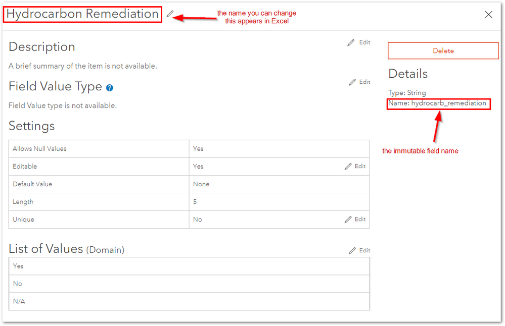

MicZatorsky_AEC
Find the feature layer that your survey uses  > Data tab > Fields tab
Select a field, change the name.  For example:
SwathiIyengar
@MicZatorsky_AEC - thanks a million!
