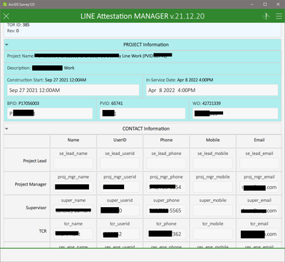

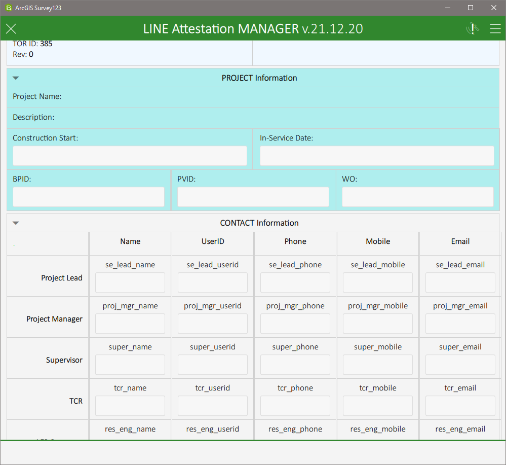

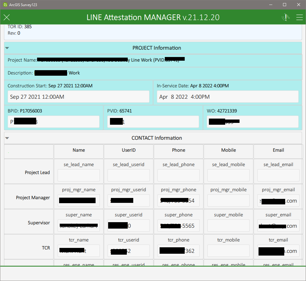

A field user upgraded to Survey123 v3.14. Now, numerous fields no longer display. Upgraded my Windows version to v3.14, same thing happened. It is impacting Windows, iOS (iPad and iPhone). Two images attached - first from S123 v3.12 with all the correct fields displayed. (Sorry for the redaction.)
 The same record using S123 v3.14.
Any ideas?

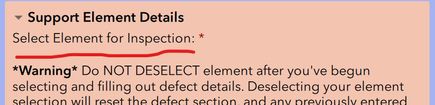

Think I'm having a similar or identical problem to yours, but signing out and back in (even removing the local copy of the inspection and redownloading it after) didn't produce any improvement.
This is what the field that's causing me problems looks like in all current versions of Survey123 (Windows, Android, iOS) for me:
(there's supposed to be an already-selected value in a select-multiple question right below the 'Select Element for Inspection Text')
My agency's institutional rep initiated a ticket and now I'm waiting to here back from Esri support.

Galen_S_MnDOT
Thank you for the response, Philip!  We are editing all existing data via the Survey123 Inbox (which has worked previously).
I'm attaching the current version of the XLS Forms spreadsheet that corresponds to the active Survey123 form.  Last week I created and published a completely new duplicate of the same form (copying and pasting columns from the old Excel sheet to the new template one at a time), and can confirm that the duplicate version presents the exact same behavior as the existing form.
This must mean that something newly added/updated in the Survey123 standalone app doesn't like how I have this question configured in the XLS Form, rather than a problem unique to the existing data in our AGOL feature service.  The question itself is on line 70 and utilizes a choice_filter expression that references three separate columns for each item in rows 99-132 on the Choices tab.
