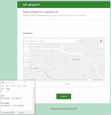

starting with @IsmaelChivite's example here to calculate geopoint from an input lat/long, I've attached another example that takes a copied/pasted lat(Y)/long(X) pair (separated by a single space) in a single input field and calculates the geopoint.
(ignore the "latitute" typo in the gif - it's fixed in the attached xlsx)
  • Survey123 Connect version 3.22.49
  • ArcGIS Enterprise 11.3
  • since this was a quick demo/test, the survey created a new hosted feature service for the survey responses
