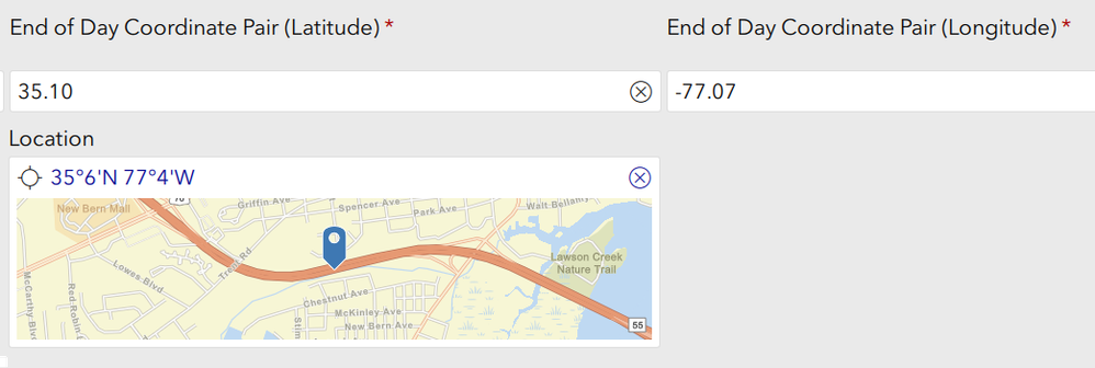

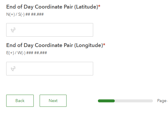

I have created a survey using Survey123 Collect.  I have given my team the ability to enter a latitude and longitude numeric value via the form.
and I'd like the points to be visible on my AGOL web map.
I am NOT using the map interface approach (which works for 99.9% of my projects) and I won't go into the details as to why not 🙂.  The map interface approach would look like this
I really just want to know if or how to get a point on a map using the manual entry Lat/Long fields vs doing it the more typical way via the map based interface.  Could this be based on a calculated field in my excel spreadsheet using Connect?

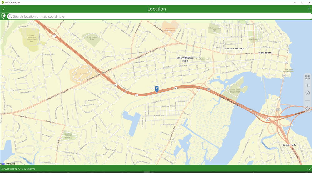

GregReinecke
Ismael,
Thank you so much but still a small challenge.  I added the geopoint type and referencing my names for lat and long as you instructed.  When I ran the survey it popped up a map at the correct location!!!!

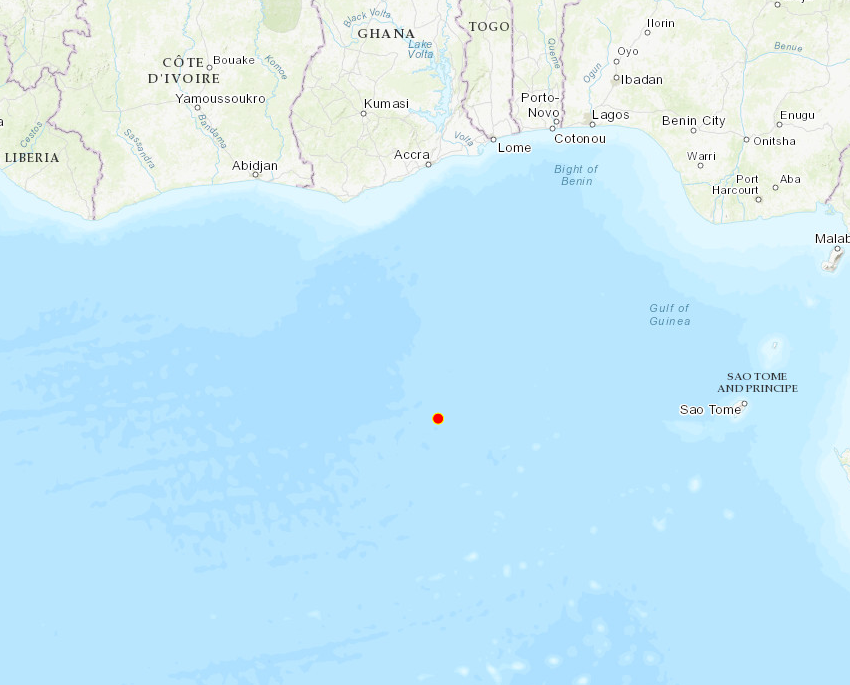

However when I opened my webmap the point plotted in the spot "for lost points 🙂".

and I clicked on the checkmark in the lower right corner. That added another point off Africa as well.
It all looked like it would work perfectly but it didn't seem too. Any other guidance would be very helpful.

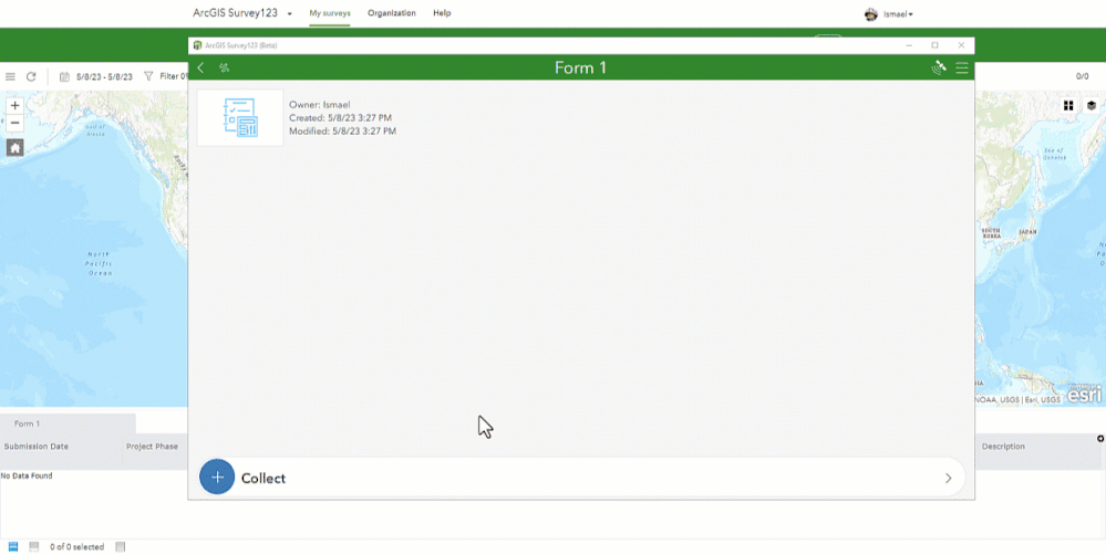

IsmaelChivite
Esri Notable Contributor
@GregReinecke  I am not sure what is not working for you. I took your XLSForm, published it, and tested it.  As far as I can tell, it is working good. See animation below.
GregReinecke
Thanks again for sticking with this. In the end, I pulled all the content from my excel file (old version for sure) and pasted it into your excel file (new version) and it all worked well. Perhaps during that process I fixed an error on my side. Either way your help is so very much appreciated!!!!!
