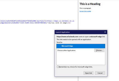

You can try to specify a browser in the URL:
<A HREF="microsoft-edge:http://your-survey-url">Take this survey!</A>
When you click the link, it will attempt to find the specified app.
Of course, that doesn't force your users away from IE, but at least prompts them for a different browser if possible.
