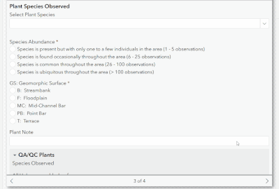

I would have a repeat and drop down box to pick from the 800 long list with type ahead.  Then the two comments fields in the repeat also.  That way they can add any number of violations.  Having 800 yes/no questions is for sure not the way to go.  The schema would be a mess.
If they want a summary page of all violations at the end that is easy enough to do with a join.
Same basic idea as my species list form below.
Hope that helps

Hey, @DougBrowning . I appreciate the response. I actually previously implemented your plant species suggestion above on another form and it works beautifully, so thanks for that one!
I had the same thought, but unfortunately I don't think it'll fit the bill unless I can add additional functionality to the repeat table. The way the Word doc functions now is that it identifies what rule/statute is applicable to the violation (if X Violation then Rule 1234 applies, if Z Violation then Rule 678, etc.) and then creates a new row at the bottom of each section for each violation/description/remedy.
