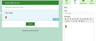

Possible Workaround: Embedded Image
Let's see how this works.
  1. Upload an image to your portal.
  2. Share it publicly.
  3. Copy the URL for the image:
  4. In your survey, add the image to a Note question, or put it in the "Thanks for submitting" screen.
Now, every time the survey is loaded, the "Number of Downloads" count increments.
It's a bit hacky, but it should give you the number you want.
