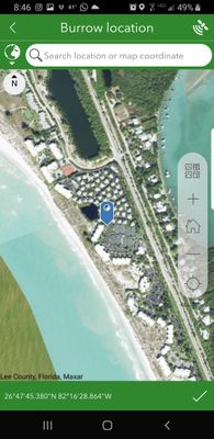

@Laura_B I made the map "Gasparilla Random Points" public to see if that would help even though I was logged in to my organization on the field app, and I am now able to see the basemap as an option (first screenshot I just posted) but only when viewing the map through a map entry question, which would be fine. However, with that selected (screenshot #2), I don't actually see any of the map contents, namely the random points (as shown in the ArcGIS Online screenshot #3). What's wrong, why doesn't the basemap appear properly?

Sean_McKnight
I thought I should be able to see the basemap from there as well, is that not the case? I do see it as an option within a geopoint question, but when I select it, it does not show the points or anything on the map (see above, just posted)

BarbaraWebster1
Since the linked content is associated with a specific survey and the location status menu is more of a settings menu that isn't tied to a specific survey, it just shows the default basemaps.
For the Gasparilla Random Points map do the feature layers have the same sharing permissions as the web map?
