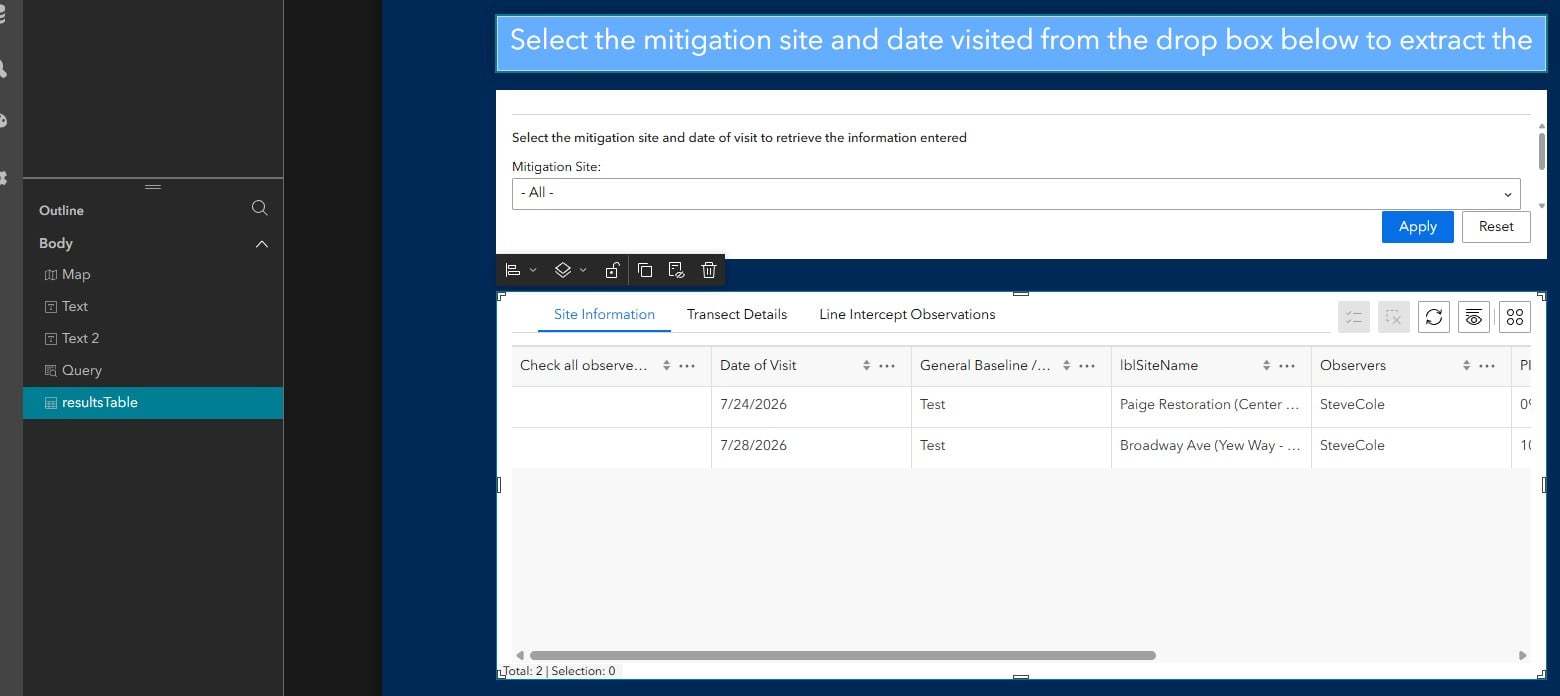

Backstory- I'm developing a very simple EB based front end to allow my users to export S123 records to CSV. The S123 has a feature class with 2 related tables (there are 2 repeat sections in the survey). The EB project only has a Query widget and then a Table widget below it. The Query widget is associated with the S123 web map that contains the feature class and the Table widget also points to the same S123 feature class & related tables.

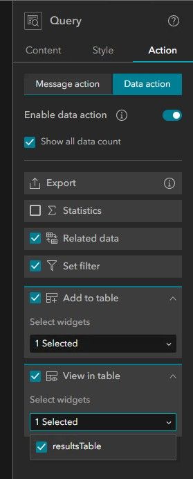

Desired Workflow- Ideally, my users would select the desired records using the Query widget and then the Query widget would then select the same records in the Table widget using the Query Widget's Action. But it's not happening even if the Action pane infers that it *should* happen-
I've tried developing this initially without a Map widget and now with a map widget (hidden behind the table widget since it's not needed visually) and I can't get the Query widget to auto update / filter the table widget contents.

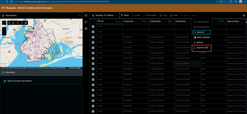

I recently discovered the Manager Instant App and used it for Survey123 survey management. I was able to set it up with the feature layer associated with a survey, allowing others to edit results. There is a very simple, easy way for end users to export the results to a CSV built in. You may be able to use this out of the box or configure it for what you described above.
Manager—ArcGIS Instant Apps | Documentation
311 Requests - Street Conditions (Esri Example)
