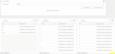

Can you use the Filter widget instead and avoid using query widget actions?  I'm a couple months out from the last time I configured an ArcGIS ExperienceBuilder app, but in theory:
  • Filter widget data source is the map (layers/tables)
  • Table widget data source is the map (same as above)
When the user sets Filter(s), I think it should automatically update/filter the tables, since they're using the same data source.
Since you don't need the map - have you tried this as an ArcGIS Dashboard using just the layer data as the dashboard source?  Seems like a couple selector filters in the header and a table widget with export enabled would suffice.  Note: I'm not sure how the related tables would be handled though...

As with most things ESRI, you tend to get most of the way there before stepping on a rake & get hit in the face. Your suggestion seems straightforward enough but it's not working either. I've designed the filter SQL query in the exact same way as what I've done with the Query widget but at runtime, there are no values to select in the pulldown.
Query widget SQL design:
Query widget runtime:
Meanwhile, filter widget SQL design:
and filter widget at runtime:
ToddW_stl
It looks like you're trying to set pre-determined filters - I set the Filter widget to use Custom filters in my solution to this other post - and users were able to select from a drop-down after choosing the field of interest.  I still may recommend trying ArcGIS Dashboards, as this is a simple filter, view, export workflow and ExB may be overkill.  Either way I'll try to set aside some time tomorrow to mock up some data and see if I can duplicate what you're trying to do.

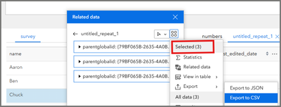

Understood - Dashboards should be a smaller learning curve than ExperienceBuilder, but still requires some knowledge and practice.  I think my test with ExB aligns with your experience - too many clicks and a VERY clunky workflow.  If you want more details on that, ok.... I wouldn't recommend it, but I'm happy to share.   😀
It also looks like you might just be able to Export the related records directly from within that parent table's action buttons, without needing to open the children in their own tables.
