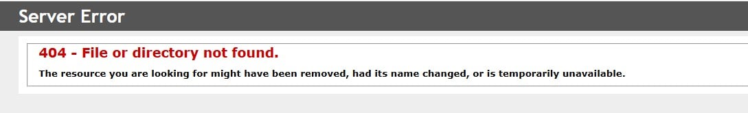

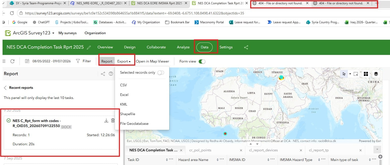

I have a problem with my Survey123 forms, the subject itself is clear, when I go to any Survey123 that I published and owned and try to export a sample report or generate a report or even export raw data, after some seconds, it shows me 404 - File or directory not found as demonstrated in the screenshots attached. The case has been like this for a 2 weeks or more (not sure), and I need to export reports for my work necessarily.

i'm getting the same when trying to export to an excel file, my survey was published with Survey123 connect and its a hosted layer in ArcGIS Online.
can you both check that Export data from hosted feature layers or hosted tables is enabled?
