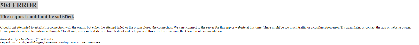

HI everybody,
I've published a public survey on my company's Portal and everything was working without any issue since a couple of weeks ago.
Then the survey was no more reachable due to the following error:
It seems to be a problem on the CloudFront server.
Any of you is experiencing the same issue?
Can you help me?
P.S. Due to security policy our Portal is reachable only through VPN connection
Many thanks,
Riccardo

SalomaoFortaleza
Dear,
Can you identify the cause of the problem?
Solved?
I'm also having the same problem.
SalomaoFortaleza
Here it was resolved.
A policy that came with a Firewall update was blocking the survey123.arcgis.com form.
The people who take care of the Firewall managed to solve it.

SalomaoFortaleza
The people who manage the firewall said that they freed up inbound traffic, coming from AWS to the Arcgis Portal machine.
