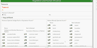

Add the photo to the media folder then you can name it in the media::image column for a question and you can do it on the lists as well.   

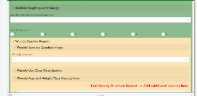

If the image is large what I do is wrap it in a group - it is out of the way until the user needs it.
