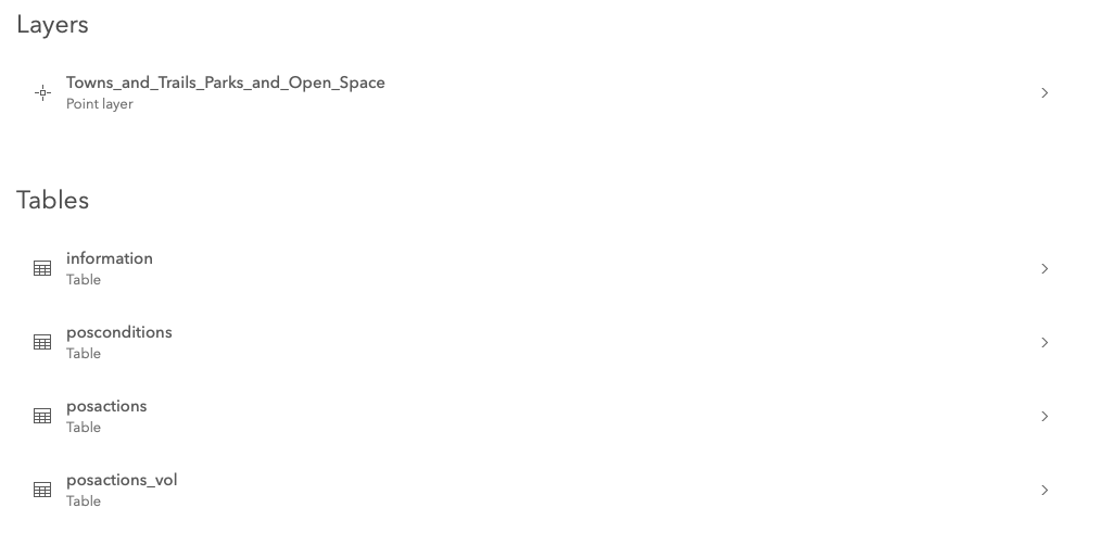

  2. Each of the surveys contains the default geopoint and four related tables (see below for an example).
    For the each of the tables, I have a hidden field, that is populated via an "incoming" field from the Field Maps link. The "incoming" field is the name of the feature. In the case above, there is a field in the feature layer called "AreaName" and that will populate the hidden field in each of the tables.
I am going to use the tables for display in online maps, dashboards, and/or experience builder. The Field Maps, that users will interact with, only contain one field which is the name of the feature and the link to the affiliated survey. Users do not edit the feature at all, it is static.
My inclination is to not relate these surveys to the existing feature layers by downloading, establishing relates in Catalog between the feature layer and tables, and re-loading everything to ArcOnline and then changing the URL in Survey123 Connect to point to the feature which I related the tables to in ArcPro (this is how what I understand I would need to do).
