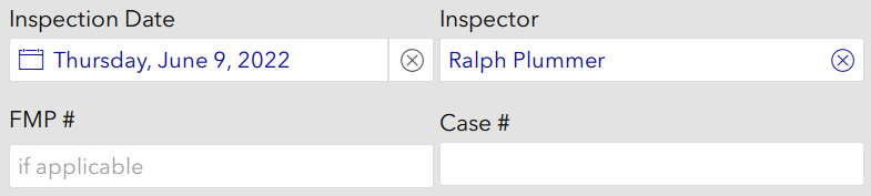

Hello

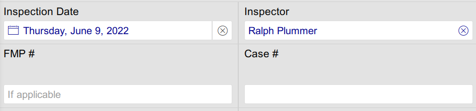

I am having an issue with placeholderText=@[hint] causing a huge gap between the label and the entry box.  This occurs on the PC and iPhone field apps (see Pic #1).  When viewing in Connect and an Android field app, it displays correctly (see Pic #2).  This is happening on multiple fields, but the one shown in the pictures below is a text field with the words "if applicable" typed into the hint column.  Is this a known issue and if so, is there a suggested fix?  Thank.
Connect v3.14.281
Field App v3.14.262
Pic #1 on PC field app that shows gap.
Pic #2 on Connect that shows no gap.
BarbaraWebster1
Hi @RalphPlummer,
Thanks for sending your XLSForm. I was able to reproduce the behavior you're seeing. It looks it's a result of an issue with how questions with placeholder text are displayed when they are used with the pages style and on a page that is not the first page. I've filed this as a bug and added your use case.
In the meantime since all the workaround involve moving the question to the first page or removing pages altogether, the best approach for your survey may be to just make the placeholder text a regular hint or guidance hint. If I find any better workarounds, I'll let you know.

Hi @RalphPlummer,
