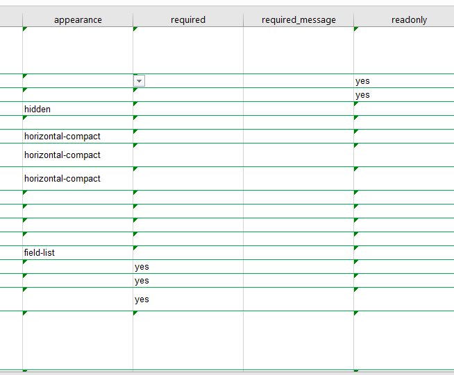

Some of my forms are 3+ years old.  I tried the new update template tool today and well it did not go great.
All my drop downs are a mess now.  Errors on everything
Any ideas here?  thanks

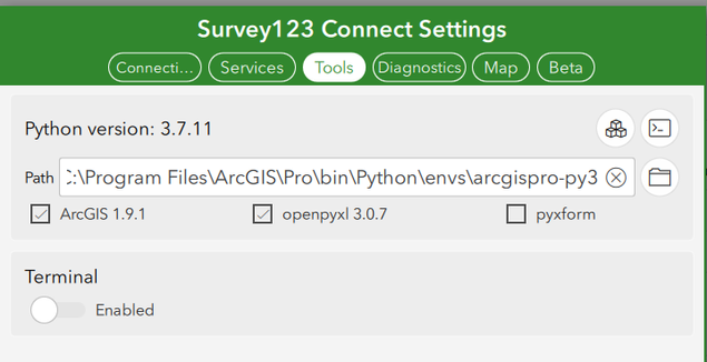

Hello @DougBrowning
What version of openpyxl is being used in the Python environment you have configured with Connect?

ZacharySutherby
Hello @DougBrowning
Thank you for confirming! There was an openpyxl bug at that version (and prior) that is causing the data validation issue you are seeing. If you update ArcGIS Pro to the latest 3.0.3 version that should update your openpyxl package to 3.0.9 and the issue should be resolved. Alternatively you can clone your default Pro Python environment and update the package directly in the cloned environment.
Thank you,
Zach
