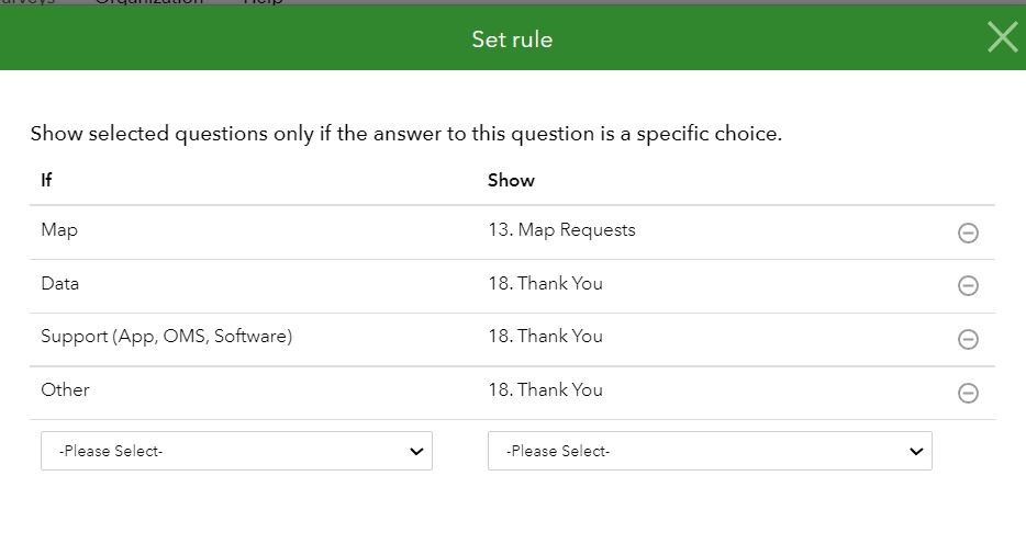

The issue comes inside the If/Then drop down redirects for the request Type-
Choices and redirects are supposed to be
Map = question 13
Data = question 18
Support= question 18
Other = question 18  Like this-
But the branches other than "Map" are giving me a phantom page 5 of 6.....

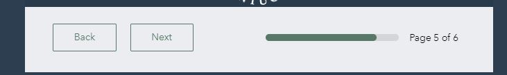

They all eventually make it to the correct page (Question18 on page 5) but first a pit stop in some random page 5 of 6 which is not in the design anywhere.
It doesn't even say anything but Back and Next -
Survery 123 issue drop down extra pages.JPGSurvery 123 issue drop down extra pages.JPG
 ( Phantom Page of supreme irritation )

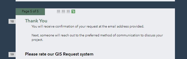

If you click "Next" it will kindly take you to the designated route- question 18- page 5 the "Thank you" page that was intended.
Here you can even see the branches listed (question 11=  18 Page 5 of 5)
There isn't even a page six!?
