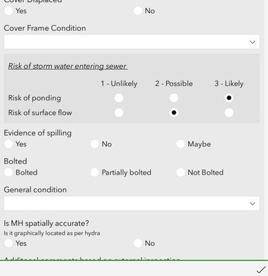

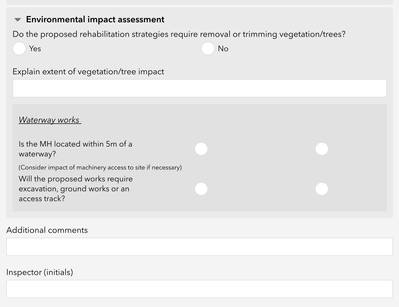

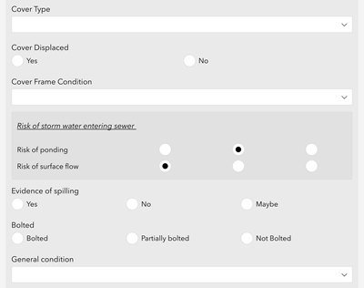

The choices are no longer showing in the app for a table-list appearance. This app version is 3.13.244
this is in version 3.12.274
Can this be fixed easily with different people and devices using this?

Hi @Felicitychun,
Thanks for sharing your XLSForm. I can confirm this issue has already been logged as BUG-000144253. I would suggest raising this issue with your local Esri Support and having them attach your account to the case, so you can track the progress.
This issue only occurs when you first open the survey or first make the table-list question relevant. If you collapse and expand the group or repeat that the table list questions are inside, or you make the group not relevant and then relevant again, you will see the labels displayed. You can do this in your survey by making the "Was MH located?" toggle between yes, no and yes, and then the group "External Inspection" will change relevance, so the labels then display. Or just collapse and expand that group.
Regards,
Phil.
