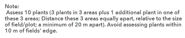

I tried to make the first word in a text string (this is a note question)
<div style="font-weight:bold">Note:</div> Assess 10 plants (3 plants in 3 areas plus 1 additional plant in one of these 3 areas; Distance these 3 areas equally apart, relative to the size of field/plot; a minimum of 20 m apart). Avoid assessing plants within 10 m of fields’ edge.
Survey123 Connect
Webform
Now I will be the first to admit that I am new to <div> tags so I may be doing this completely wrong but if I am why does it give me what I want in Connect but not the webform  Also, why is the exact same code adding in a <br> for no reason?

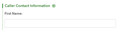

Another issue that I ran into is group labels also do not recognize the new HTML formatting in the webform.
begin groupContactInfo<div style="text-align: center">Caller Contact Information</div>
Survey123 Connect
Webform
Once again, the webform does not recognize this new "modernized" formatting.

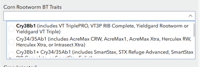

Unfortunately I have come up with yet another example of how the new HTML formatting is just not working.
This example occurs in a choice list.  Included below is an example of the old way of HTML formatting vs. the new HTML formatting.
list_namenamelabel
CRW_BT_TraitsCry3Bb1<b>Cry3Bb1</b> (includes VT TriplePRO, VT3P RIB Complete, Yieldgard Rootworm or Yieldgard VT Triple)
CRW_BT_TraitsCry34_35Ab1<div style="font-weight:bold">Cry34/35Ab1</div> (includes AcreMax CRW, AcreMax1, AcreMax Xtra, Herculex RW, Herculex Xtra, or Intrasect Xtra)
CRW_BT_TraitsCry3Bb1+Cry34_35Ab1<div style="font-weight:bold">Cry3Bb1+ Cry34/35Ab1</div> (includes SmartStax, STX Refuge Advanced, SmartStax RIB Complete, or SmartStax Enlist)
You can see the difference right away as to what HTML formatting is working and which is not.
Survey123 Connect
What makes this issue interesting is for some reason it actually works in the webform... sort of.  It still adds a phantom <br> for no apparent reason.  This is also still very much an issue.
Also, the webform actually respects both versions  of HTML formatting.  So you can use the old HTML formatting in some parts of the Survey123 webfrom but not others?
Where is the consistency here?  I'm even more confused now than I was before.
Webform
