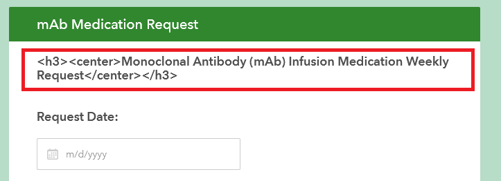

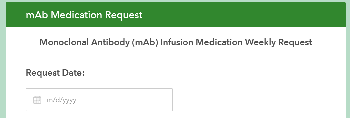

For example, this old school HTML:
<h3><center>Monoclonal Antibody (mAb)</center></h3>
Could look like:
<span style="text-align:center; font-size:large; font-weight: bold">Monoclonal Antibody (mAb)</span>

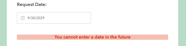

This old HTML:
<center><font color='red'>Enter a date in the past</font></center>
Should look like:
<span style="text-align:center; color:red; ">Enter a date in the past</span>

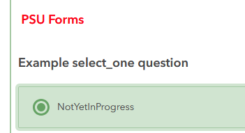

Background colors
You can set the background color of questions, notes and group labels. The old school HTML would look like this:
<body bgcolor="#f6beb2"><font color="#cd3212">You cannot enter a date in the future</font></body>
Again, you will want to use span styles now. The appropriate property is called background-color and it takes an HTML color name or an hexadecimal color value.
In the example below, I changed the color and weight of the text and applied a background color to the label of a note.
The HTML syntax, applied to the label column of a note question, looks like this:
<span style="text-align:center; font-weight:bold; color:#cd3212;background-color: #f6beb2; ">You cannot enter a date in the future</span>

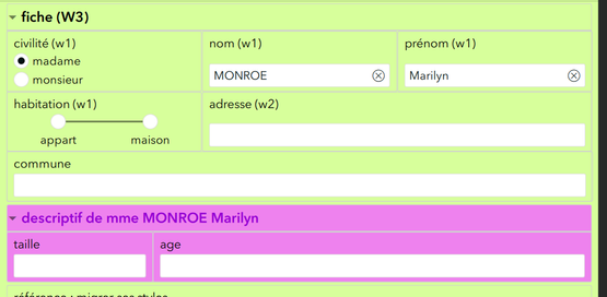

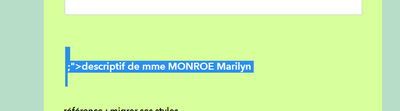

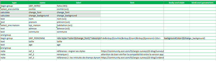

Hello everybody,
i am trying to migrate my styles with a test form before going further.
I have got a bad display in the webapp.
I use two calculations to change the font color and group background.
Everything is ok in the app.
if(selected(${civilite},'mme'),'DarkViolet ',if(selected(${civilite},'m.'),'blue',''))
if(selected(${civilite},'mme'),'Violet',if(selected(${civilite},'m.'),'LightSkyBlue ',''))
The form look like this in web app 3.13 form (hmm... Not good!)
and like this in the app (good!)

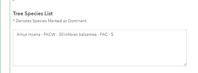

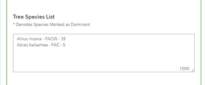

I have a note type field that is populated with a running list of values entered in a repeat, which allows the user to quickly see which items have been entered without needing to cycle back through the repeat.
Up through v3.12 I have been using join("\n",${species}) in the calculation field so that the note shows each record on its own line, making it much easier to read.
This method still works on the mobile app for v3.13, but now in the web form the note field simply prints all records on a single line with the \n text between each one.
Is there a way to replicate this setup with the new html codes (or some other method) that will work on both the mobile and web versions?
As far as I can tell the html tags do not work in a calculation, and I have not been able to come up with any way to replicate the setup that we have for v3.12.
Our data data collection uses the mobile app, and our QC process relies on using the web forms, so we need to have a setup that works well on both.

@DGiblinHave you tried using <br>?
This isn't something I have tried in a text box though. Works well for notes.
DGiblin
@abureaux  - Yes, I have tried to use <br>, but anytime I add that to the calculation it will either cause an error in the conversion if not in quotes, or if I place it in quotes then the resulting note contains that text instead of acting as a line break.
I have used <br> successfully in labels and hints, where the text values are static.
In those cases it works for both mobile and web versions of the form.

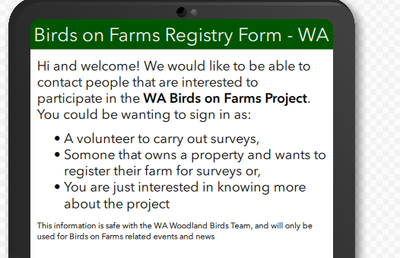

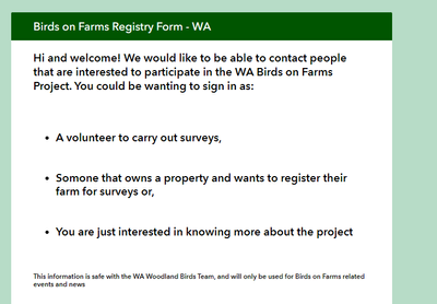

Hey! Im also finding issues while applying styles to the Webapp when designing in connect. And can't seem to center images either.
Image1: Connect. Looks nice and how I've intented it to be 😎
Image 2: Webb. Looks awful (🤣
Code (sorry....first time with HTML)
<div style="font-size:20px;">Hi and welcome! We would like to be able to contact people that are interested to participate in the <b>WA Birds on Farms Project</b>. You could be wanting to sign in as: <ul style="list-style-type:disc;">
<li>A volunteer to carry out surveys,</li>
<li>Somone that owns a property and wants to register their farm for surveys or,</li>
<li>You are just interested in knowing more about the project</li></div>
<div style="font-size:12px">This information is safe with the WA Woodland Birds Team, and will only be used for Birds on Farms related events and news </div>

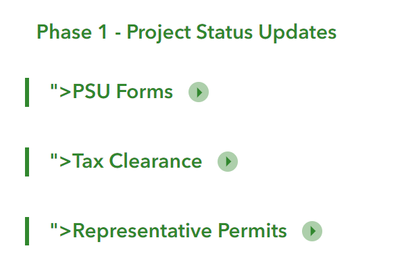

JillHalchin
@IsmaelChivite I'm working with Connect verion 3.16.110.  When I updated an older spreadsheet, it became version 3.19.  When working to update the html, I found that I have to use <div> instead of <span> for a Group.  I noticed that you originally wrote your post using <div>, then updated is last year. Do I need to use <div> because of our Connect version?
abureaux
MVP Frequent Contributor

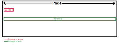

@JillHalchin<span> should work fine in groups. What isn't working exactly?
The only thing that I can think of off-hand that wont work is the center tag. A <span> is as large as the content it contains, whereas a <div> is always the width of the page.

CarissaFoley
So I tried to follow these guidelines for my survey but I am still seeing below in the web version of my survey for the group headers:
I have a calculated value that turns the header a different color depending on the status of the project. The labels look as follows: <span style="color:${PSUColor1}">PSU Forms</span>
Any insight would be super helpful. Thank you!
abureaux
Try replacing ${PSUColor1} with a color (e.g., Red or #FF0000). Do you still see the issue? If so, check the calculation for ${PSUColor1} for errors.
CarissaFoley
@abureaux so that was a good idea to test, thank you! When I subbed in the color, it looked as intended. However, there are no errors being thrown in my ${PSUColor1} calculation when I look at it. It reads as follows in the calculate field:
if(selected(${PSUStatus1}, 'NotYetInProgress'),'Red', if(selected(${PSUStatus1},'InProgress'),'Orange',if(selected(${PSUStatus1},'Submitted'),'Gold',if(selected(${PSUStatus1},'Approved'),'Green'))))
It works fine in Connect, but it is when I publish it and open it on the web that it looks like what I had posted initially. The user basically selects one option from the "Status" field, and then the heading color is supposed to change depending on that status selection.
abureaux
Your IF() statement has an error. Missing the final IF False (see below). Is that how you have it entered in Connect? Connect should have picked up on that (so wondering if it's out of date).
if(selected(${psustatus1}, 'NotYetInProgress'),'Red', if(selected(${psustatus1},'InProgress'),'Orange',if(selected(${psustatus1},'Submitted'),'Gold',if(selected(${psustatus1},'Approved'),'Green',''))))
Beyond that, the issue is that the Web Form appears to not support calculates in Group labels it seems. Honestly, I could have sworn they did.
It is supported in regular text though:
If a new line of text doesn't work, you could try emojis as an alternative for the Group label:
abureaux
Sorry, one more thing (I did this without thinking...). You need to cram everything into the calculate for it to work in the web:
if(selected(${psustatus1}, 'NotYetInProgress'),'<span style="color:Red">PSU Forms</span>', if(selected(${psustatus1},'InProgress'),'<span style="color:Orange">PSU Forms</span>',if(selected(${psustatus1},'Submitted'),'<span style="color:Gold">PSU Forms</span>',if(selected(${psustatus1},'Approved'),'<span style="color:Green">PSU Forms</span>','PSU Forms'))))
CarissaFoley
@abureaux thank you for the guidance, I may need to go that route if it is continuing to show up poorly on the web. Either that or move some of my folks into Survey123 on the desktop. So the groups I currently have like the "PSU Forms" group are actually nested within a larger group, so I wonder if that itself could be causing issues as well. I will take a try at what you have provided and see how I do. Thank you!
