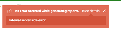

Good morning, I would like to know if anyone is experiencing the same problem. Suddenly our Survey123 reports stopped generating with the following error: Internal server-side error.

I am having the same issue.  I am relatively new to Survey123 reports, but I think I followed Ismael Chivite's webinar walkthru for creating reports and attaching to emails, (as far as I can tell,) to a tee, and when I run a test, I get the "A value must be provided for source path." error in the Upload file from URL step, which Ismael says in a thread, is an indication there must be an error in the Create Report step.  Opening up the Output>Body I see  Message: Internal server side error

It happens from the Survey123 Website as well.  I do have an open ticket with them and did a screen share with an Analyst yesterday.  Nothing looked off on our system, and given the issue is affecting other Orgs as well is an indicator it is on the ESRI side of things.   I am only getting this from surveys within Enterprise/Portal.

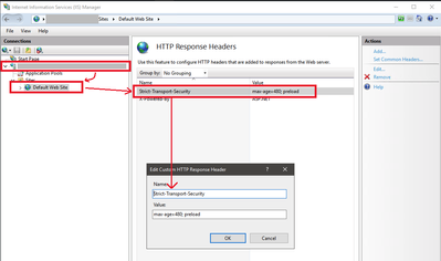

  • This happened a few weeks ago now, but a Node update on Esri's end changed how Headers were parsed from IIS. Maybe it was slow to roll out in different regions. Have you checked IIS settings? A little convoluted, but open IIS > Server > Default Website > HTTPS Response Headers (double click) > Strict-Transport-Security (double click) > inspect the entry and ensure no extra characters (e.g., spaces at the end of the string) are present.
