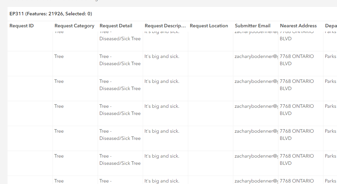

I had a weird thing happen with a Survey123 submission: I'm testing out a a survey and when I hit the submit button, the icon just sat there and spun for an unusually long time. I went into the hosted layer data tab and found that over 10,000 records had been created. the submission was still spinning and when I refreshed the data tab on the hosted layer, I found that the count was still going up!
Letting the survey submit for about a minute resulted in 20k records. It wasn't a one-off, I tested again and the same thing happened.

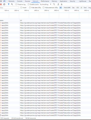

Oh man, a blast from the past. This happened to us once, too. I don't remember how the issue was resolved, though... Do you see anything helpful in the Network tab of your browser's developer tools? (Assuming you are submitting from the web form.)
- Josh Carlson
Kendall County GIS
ZachBodenner
MVP Regular Contributor
Yeah, just a rapid succession of applyEdits:
