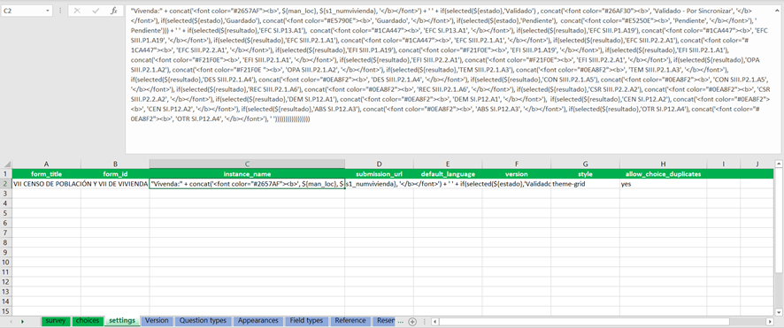

I am using the instance_name of the XLSForm  with the condition “if”, as you can see below:
I am using the condition in the instance because I want the instance_name to change when new information is added to the form.

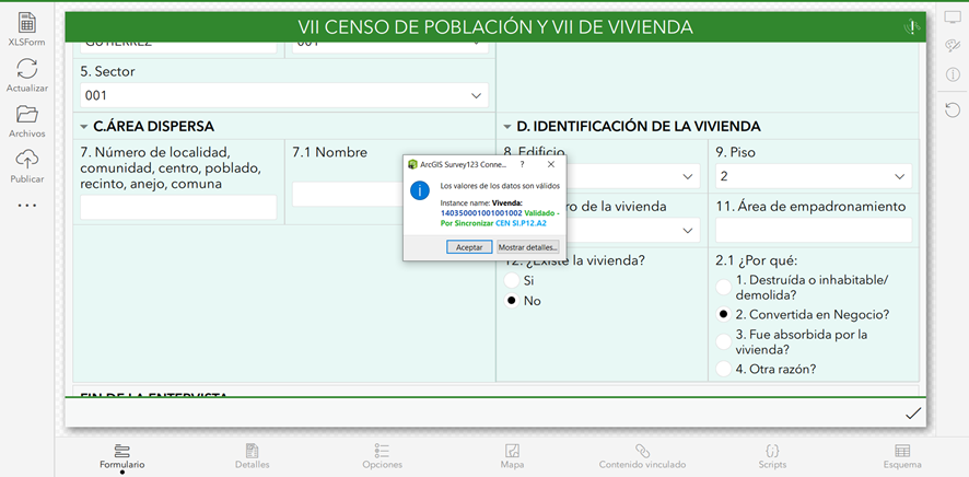

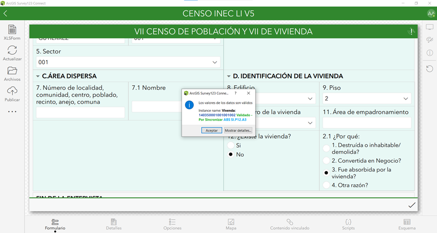

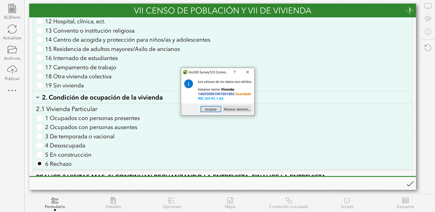

I have run a few tests and it actually does work on the desktop app Survey Connect 123, as you can see below:
Andres_Arrieta_1-1637254946255.pngAndres_Arrieta_2-1637254953366.pngAndres_Arrieta_3-1637254957047.png

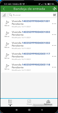

Once I publish the form to the portal arcgis online, I upload new data to the web service of the survey using the tool append in ArcGIS Pro. I do this step, so I can assign the forms to the fieldworkers through the Inbox.

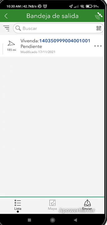

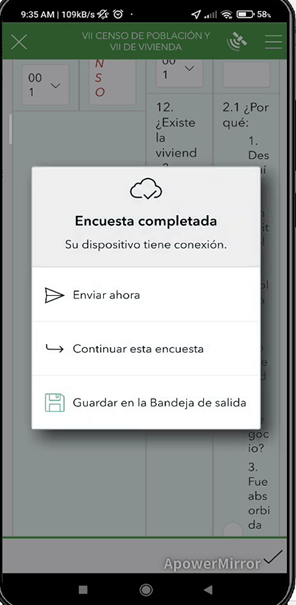

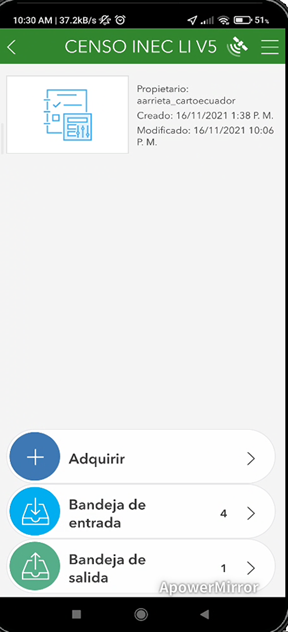

Here, the issue is when a field worker collects data in the assigned form, and sends it to the outbox, the instance_name does not change.
Andres_Arrieta_5-1637255059919.pngAndres_Arrieta_6-1637255073711.pngAndres_Arrieta_7-1637255077767.png

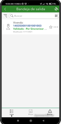

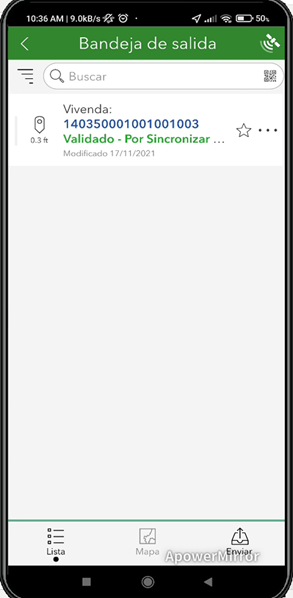

Nevertheless, when I enter data to a new form.
And answer the very same questions as I did on the assigned form.
In this time the instance_name does change when I send the survey to the outbox.
Therefore, I don´t understand why the instance_name does work when I send new data, but it does not work when I use the forms that already contain some information in it, and I just have to complete the rest of the fields, or the assigned forms in my inbox.

Also, I share my XLSForm in case you want to check it out.
