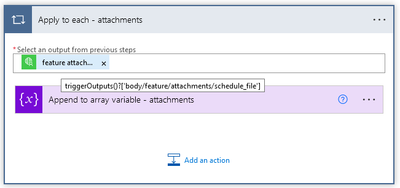

I use an Apply to each to loop over the array and subsequently append each item to an array.
I do this first step in one Flow, and then I store the results of that array in an SP list, then this next step is in another Flow. Pretty sure the Compose isn't necessary if everything is in a single Flow, but I'll include it anyway for posterity. EDIT: For those reading that want to end up with an HTML Table as I have in my last step, and you are doing this all in one Flow: Just skip this middle step...

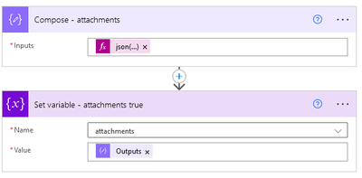

Then I Compose the array (remember when I said I am pulling my array from an SP list? You need to put your source inside json() or else you get an error) and set a Variable with that output:

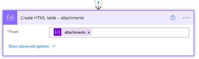

Then finally I add that variable I just set (obviously an array) to Create  HTML Table:
This is what I put into my emails*.

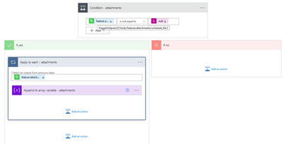

Let's jump back to my very first step for a second and zoom out a little:
I use the Condition to test to see if the array is empty. Empty = no attachments (or photos, in your case). Not empty = at least one attachment. Assuming that S123's array isn't NULL, I use my Apply to Each to loop over it and create my own array (easier to work with I find). In your case, you could use the Apply to Each to add a row to your excel table with the URL to the photo.
