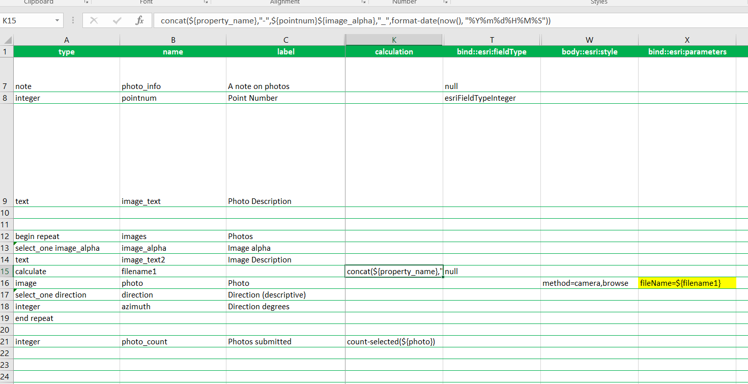

filename1 has bind::esri:fieldType as "null" and "calculation" is this:
concat(${property_name},"-",${pointnum}${image_alpha},"_",format-date(now(), "%Y%m%d%H%M%S"))

Okay, I uploaded and tried. Same issue as you...
Check out the two adjacent tags. Put a comma in there and see if that fixes it:
Also, be careful of using reserved names. It can cause issues. You will see a green triangle indicating something is wrong with a name:
It can be a little misleading, since you have to ignore that green triangle in other columns. But, the name column is a little different. You want to respect it's restrictions.

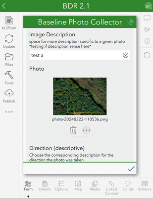

Screenshot 2024-02-22 connect image name.pngScreenshot 2024-02-22 connect image name.png
I just double checked and am running the most up-to-date version 13.19.104.0
admincrew
I made the following changes
  1. changed date name to "visit_date"
  2. added a single comma as you suggested
  3. removed all spaces from property_name list choices in "name" column just in case

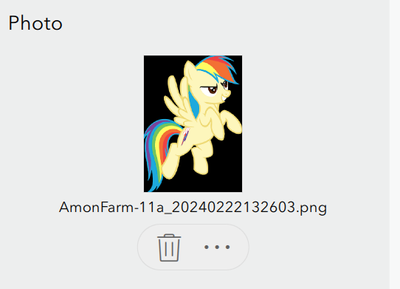

I was about to say that it didn't work.... key learning moment: don't forget to actually input the desired information in the connect app (in my case the property name, photopoint number and letter)
SUCCESS! one little comma was all it needed.
Screenshot 2024-02-22 connect image name 4.pngScreenshot 2024-02-22 connect image name 4.png
abureaux
MVP Frequent Contributor
Glad that this is working, and I love the test image!
