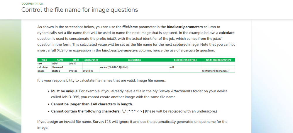

use Default or Calculate field in Survey123 Connect to set a default filename for images captured in the survey123 field app. Rather than the what is set by survey123 (a garbled mess that you can't easily sort back in the office after exporting from the geodatabase) you could use a calculation such as concat(${question1},format-date(${WSDateTime},'%Y%m%d%H%M',".jpg")
26 Comments
IsmaelChivite
This functionality is now available for testing through the Survey123 Early Adopter site. Looking forward to your feedback. Below is a partial screenshot of the doc. To test this, you need to have version 3.15 Beta (available through Early Adopter site).

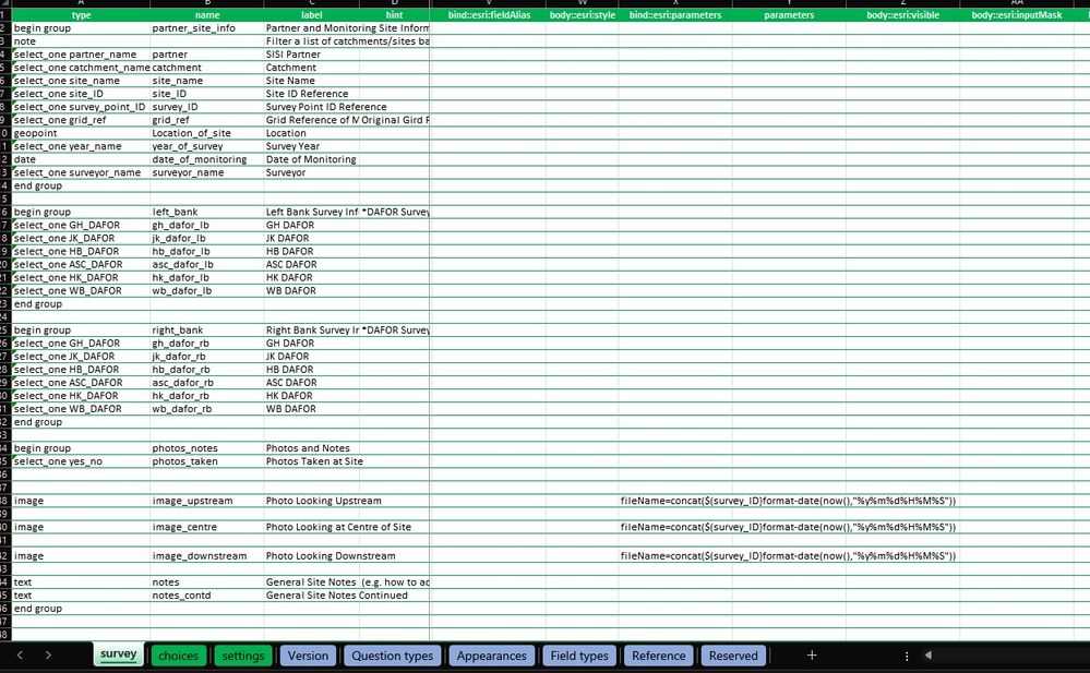

Using Survey 123 Connect version 3.17.55.0 to design the survey I've been trying to implement specific file names for images related to a Survey Point ID Reference(Label) or survey_ID (name).
In fact I'm taking three images at each specific survey point, an Upstream, Downstream and Centre and they are all related to the same survey_ID. However when I have tried the various versions as illustrated in the following links i cannot get them all to work. Often only one will work and the others are default names.
https://community.esri.com/t5/arcgis-survey123-blog/what-s-new-in-arcgis-survey123-june-2022/ba-p/11...
https://community.esri.com/t5/arcgis-survey123-blog/survey123-tricks-of-the-trade-set-the-file-name-...
https://doc.arcgis.com/en/survey123/desktop/create-surveys/xlsformmedia.htm#ESRI_SECTION2_D007264B8F...
Yet I seem to get nowhere when running the published survey on the field app and end up with just a default name for each image.
What I'm trying to achieve is something like "Dee_05_a_image_downstream_20230517-233210.jpg"
Here is the XLSF form survey data I'm using.
Any pointers would be most welcome.
Best regards Jamie

Well, please try the following sentence in your xlsx file:
 fileName=concat(${survey_ID},format-date(now(), "%Y%m%d%H%M%S"))
You can also add underscore to make it like:
fileName=concat(${survey_ID},"_",format-date(now(), "%Y%m%d%H%M%S"))
Please try and it should solve your issue.
Alison
JamieUrquhart
Dear Alison
Thanks so much for your help here this now seems to have resolved the issue and go the filename working for this survey.
