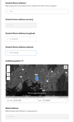

rmcooper_wcpss
I'm seeing the same thing here. I type '123' into an address input, hit tab without selecting anything, and it returns 100% accuracy, coordinates for a location in Oslo, and a match address of '0123, Oslo'. I'm not sure how that's a 100% match.
