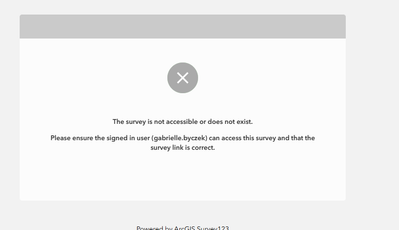

I am unable to open the survey via other applications
Why is this if, it public and in my name as the owner?
Gabrielle_Byczek_0-1744653969733.pngGabrielle_Byczek_0-1744653969733.pngGabrielle_Byczek_1-1744654013593.pngGabrielle_Byczek_1-1744654013593.png
I am trying create  a pop up on a public facing map:
<div style="text-align:center;">
<span style="font-size:large;">Street Name:&nbsp; {NAME}</span>
</div>
&nbsp;
</div>
<a target="_blank" rel="noopener noreferrer" href="https://survey123.arcgis.com/share/6ba82fca211c4484af4c9b0faf8f9bc2? portalUrl=https://gis.memphistn.gov/portal&amp;field:Parent_GUID_text={GlobalID}&amp;field:From_Street={FROMST...}">ADOPT THIS STREET</a>
</div>
Survey that works:
https://survey123.arcgis.com/share/6ba82fca211c4484af4c9b0faf8f9bc2?portalUrl=https://gis.memphistn....

Gabrielle_Byczek
Thank you so much! I got it to work by removing the ? question mark and readding it again! I will definiely save this information!
