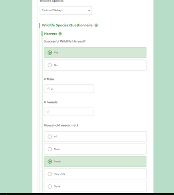

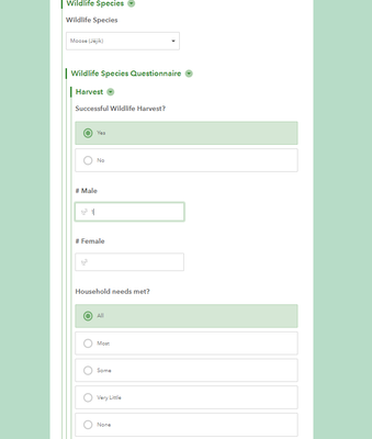

So I am kind a stuck with this one scenario where a user can have 2 different wildlife or plants or fish harvested at the same time, so survey should be able to register answer from individual species separately. like # make Moose was harvested was 1 but lets say # of Male caribou was 2 and Household needs met is SOME for Caribou. At this point there is no connection between each species and the questions asked.

I have used Repeats and its performing exactly the way i wanted it to perform. Thank you very much for all your help.
