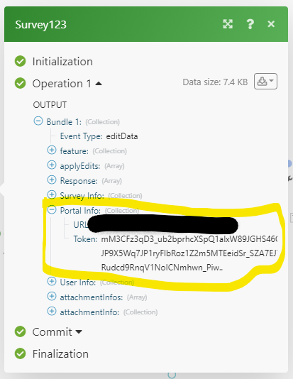

I'm working with On-prem Enterprise Portal, Integromat and Survey123 on devices (no web Survey123 edits):
Looking that the contents of a Survey123  in an Integromat watch survey module, when a survey is submitted or edited, it carries with it a Portal for ArcGIS token:
I would like to use that token later - say hours or days later - to perform edits on the feature service using the REST API.

Hi Dirk Vandervoort
You can generate the token yourself and specify how long it lasts using the http  module in integromat
Generate Token—ArcGIS REST API | ArcGIS for Developers
maybe the referer would have to be your portal i am not sure as i don't have On-prem Enterprise Portal.
