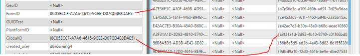

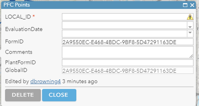

Ok this one is getting me in the web map now.
It shows globalid as lower case in the attribute table but when I run a simple calc to put it into the FormID field it suddenly goes upper case!
Now the super fantastic part is relationship classes see the uppercase and lowercase and different so it breaks all the relates!
At this point how are we supposed to program around all of this?  I know this is not really 123 at this point but these kinds of inconsistencies is a killer.  Thanks
When I open in Pro I see both again.

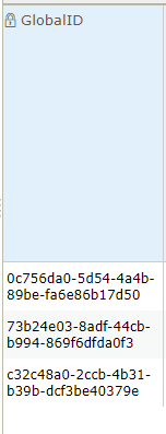

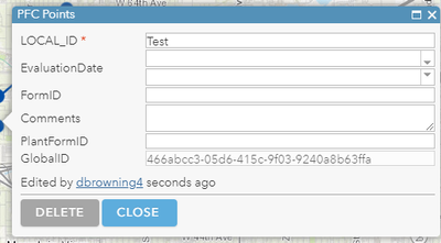

I think the lower case may be coming from Field Maps.  If I add a feature in a web map in the browser I get uppercase GlobalID.  If I use the exact same map and add in Field Maps it does lower case.
AGOL Add
Field Maps add
Then ArcPro changes the lower to upper for display
So the exact same record shows lower in AGOL and upper in Pro.

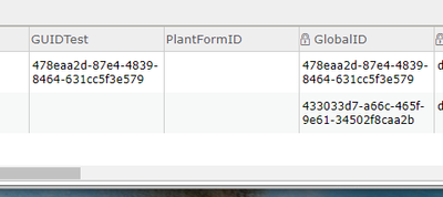

Looks like 123 is doing lower case also?
And when I look at this form in Pro I again get both depending on the attribute table or the popup
No idea which one is "correct" still.
