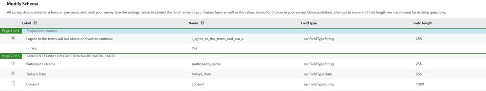

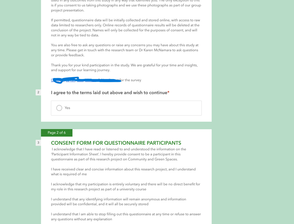

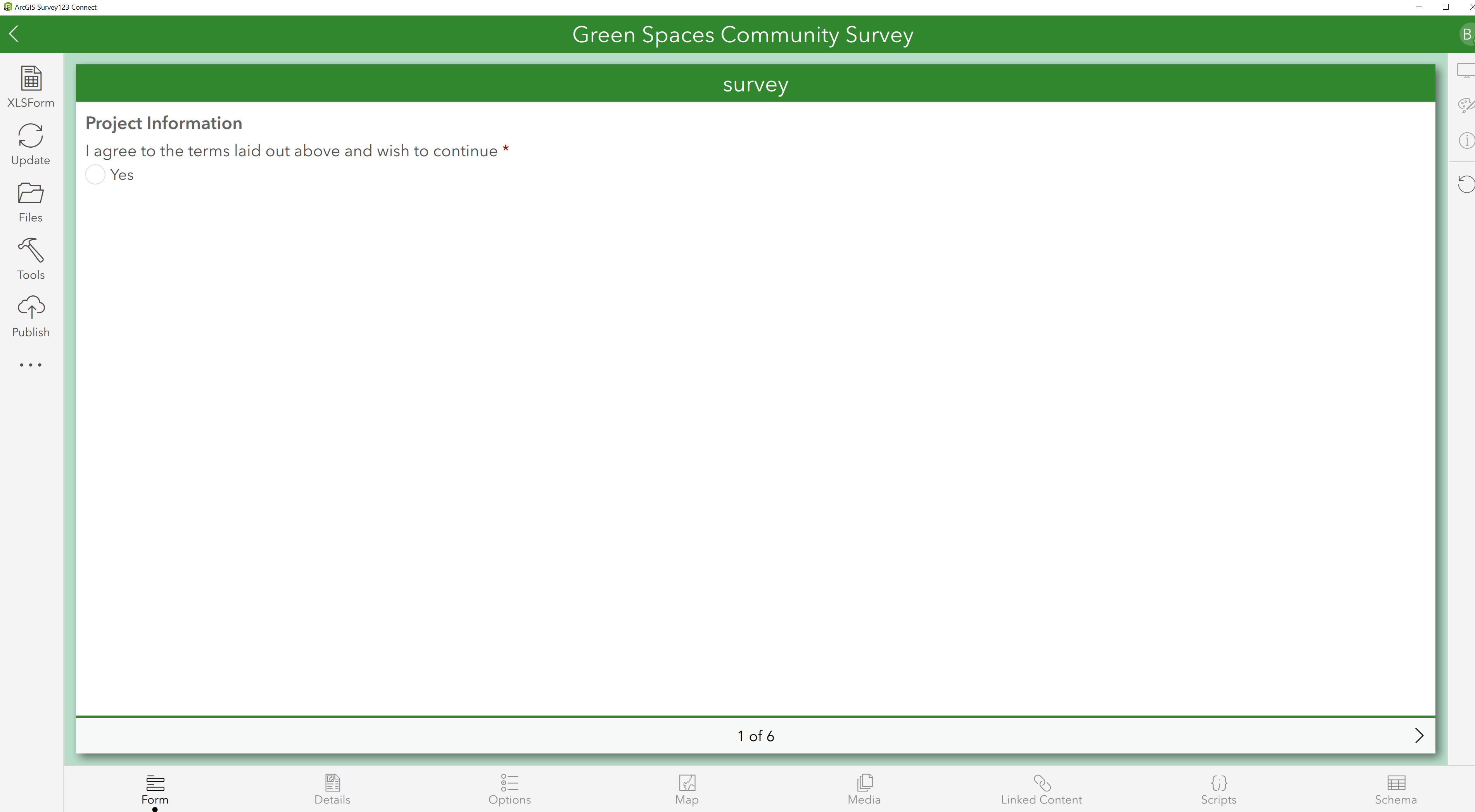

I've put together a survey in survey123 web. In order to add xlsform repeats (https://doc.arcgis.com/en/survey123/desktop/create-surveys/xlsformrepeats.htm), Ive published the survey, accessed it in survey123 connect where I'm going to add the repeats. However as soon as I open the survey in connect (without editing) - some large chunks of (very important) text are missing.

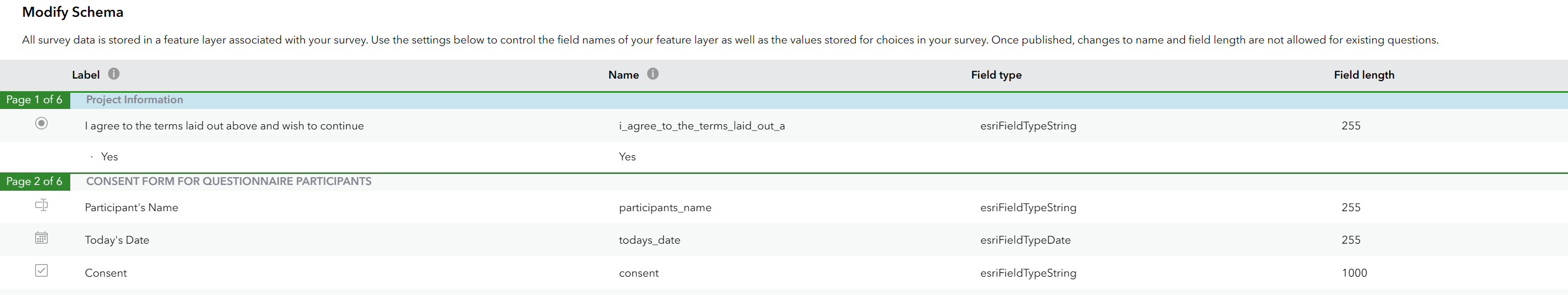

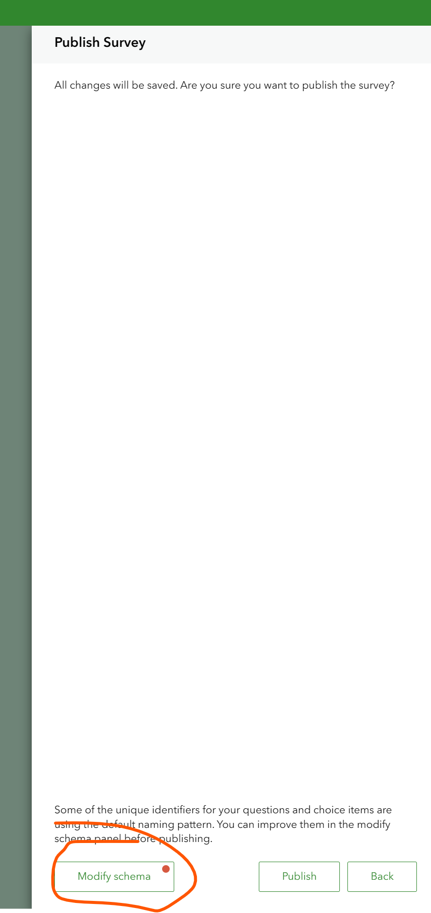

What I have just noticed is when I, in Survey123 web, go to 'modify schema' upon publish, the same fields that are missing from the Survery123 Connect version are missing in that dialogue.
Any ideas why some large chunks of my survey are missing in this dialogue, and subsequently the '...Connect' version of it?

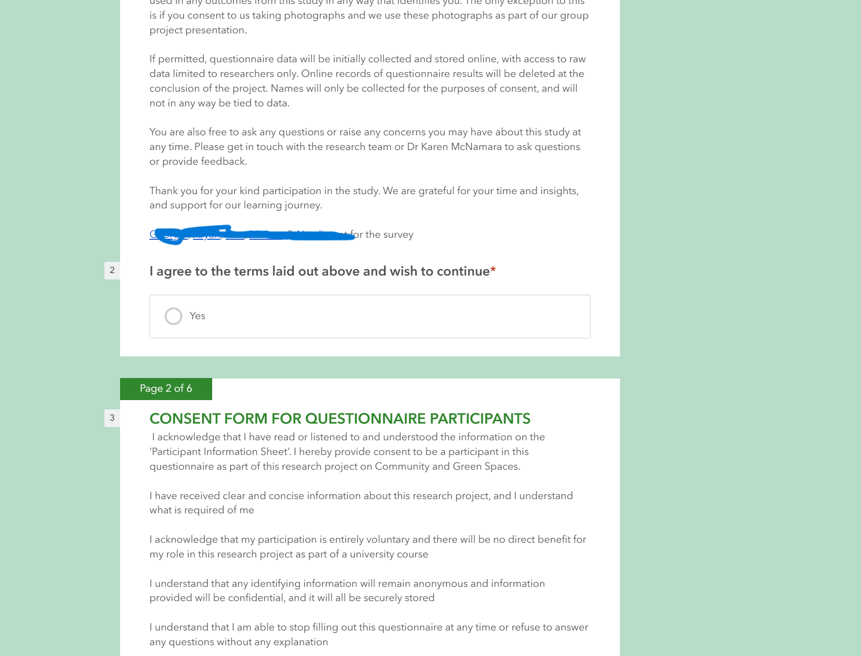

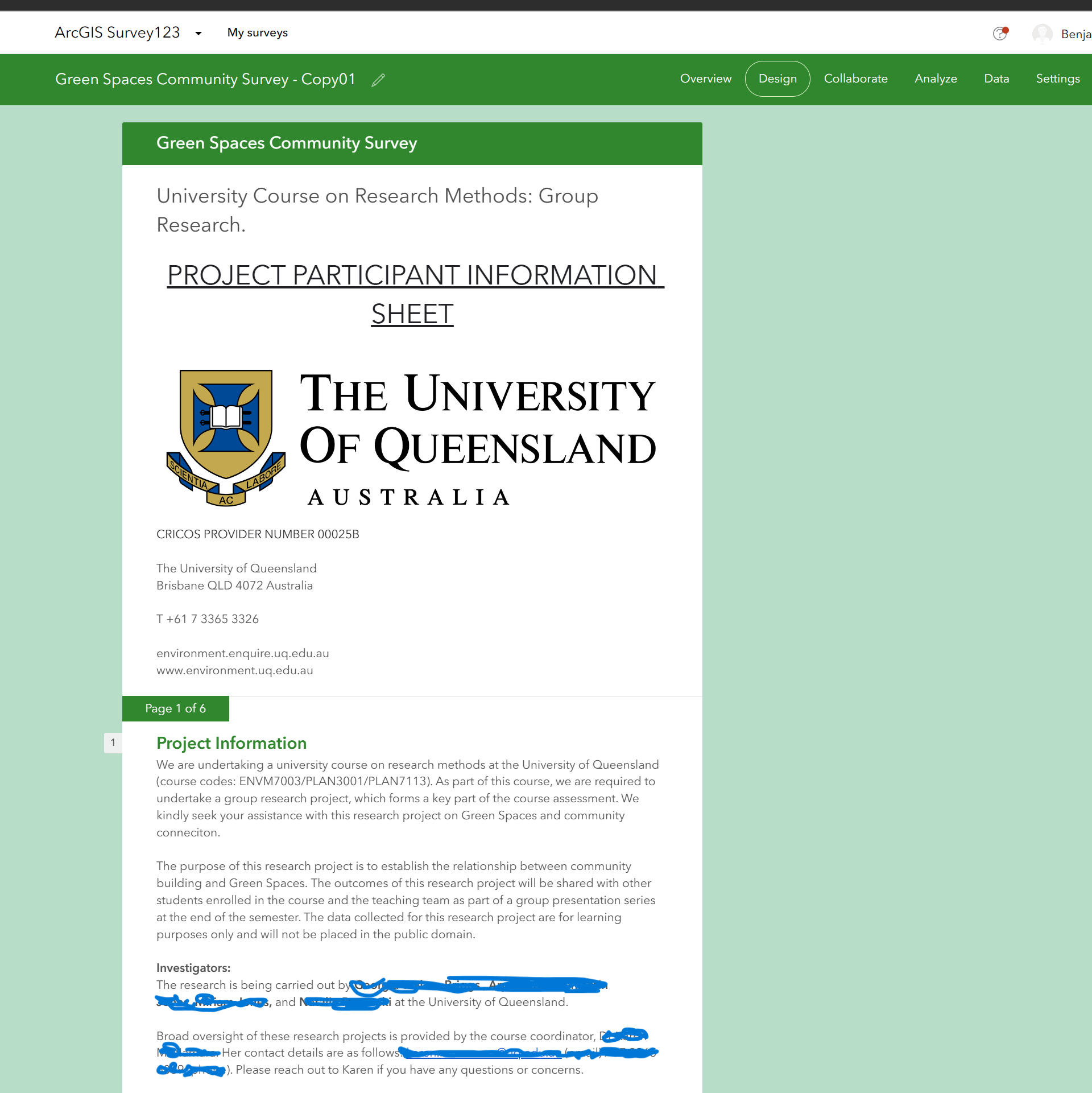

The missing chunks include my survey description, and the 1st page description text (which are substantially large blocks including ethics information
Here are images of the complete survey and then the missing data. Sorry I cant seem to get them to display in the correct order

This problem isn't being introduced when trying to bring anything back to web..this is two things: large sections of my survey has no representation in the modify schema dialogue, and, went sent to connect - the missing sections are also missing there (in the preview questionnaire )- though present in the spreadsheet

Hmm there may be some HTML in there preventing it from showing.  Temporarily remove some HTML and see if it comes back.  That is the most HTML I have ever seen in a form before.
