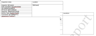

I built an inspection form in Survey 123 using a feature service as my template. The process starts with the inspector (while on the job site) use Field Maps, (1) clicks a pipe asset (2) selects an option to inspect that asset (3) Open Survey 123 form & answers question to include taking up to 3 photos (4) submits the form and it automatically returns the inspector back to field maps. With that said, the answers submit back to a table--- so when I create a report in survey 123, it does not add or allow me to add a map location ${location}...is there a way to use the photo location instead? I tried adding the geopoint but it needed a feature layer...help?

Hi Richard, First, thank you...I just tried the ${$shape} and gave me a failed to parse ...undefined error. Should I use the ItemID for the map used and how do I specify which feature? the table uses global ID/GUID as well...

Yes, it does work if I just put ${$shape} - no error but no "map" on the report...
