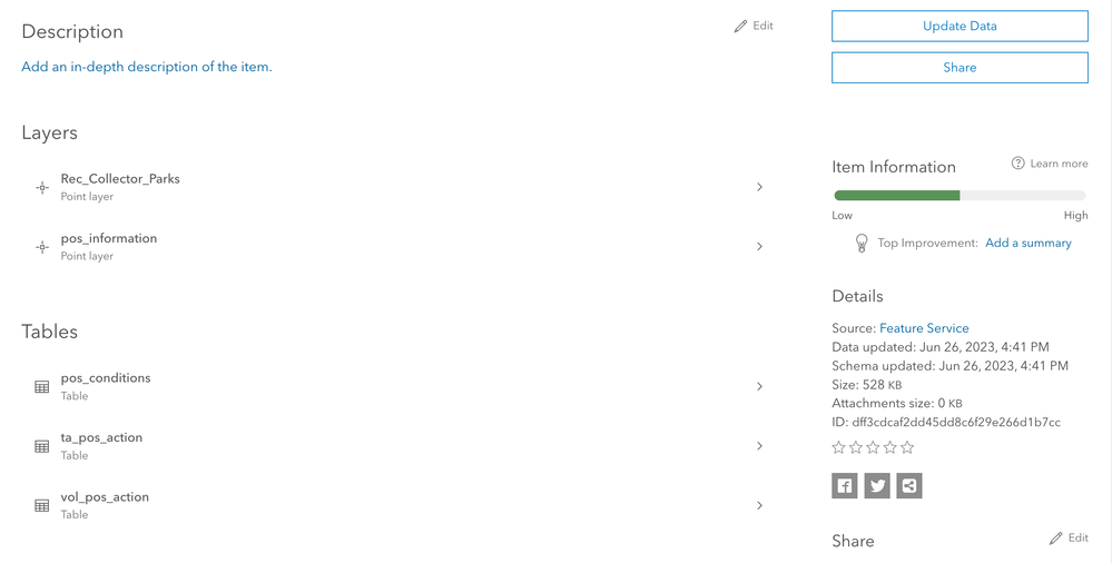

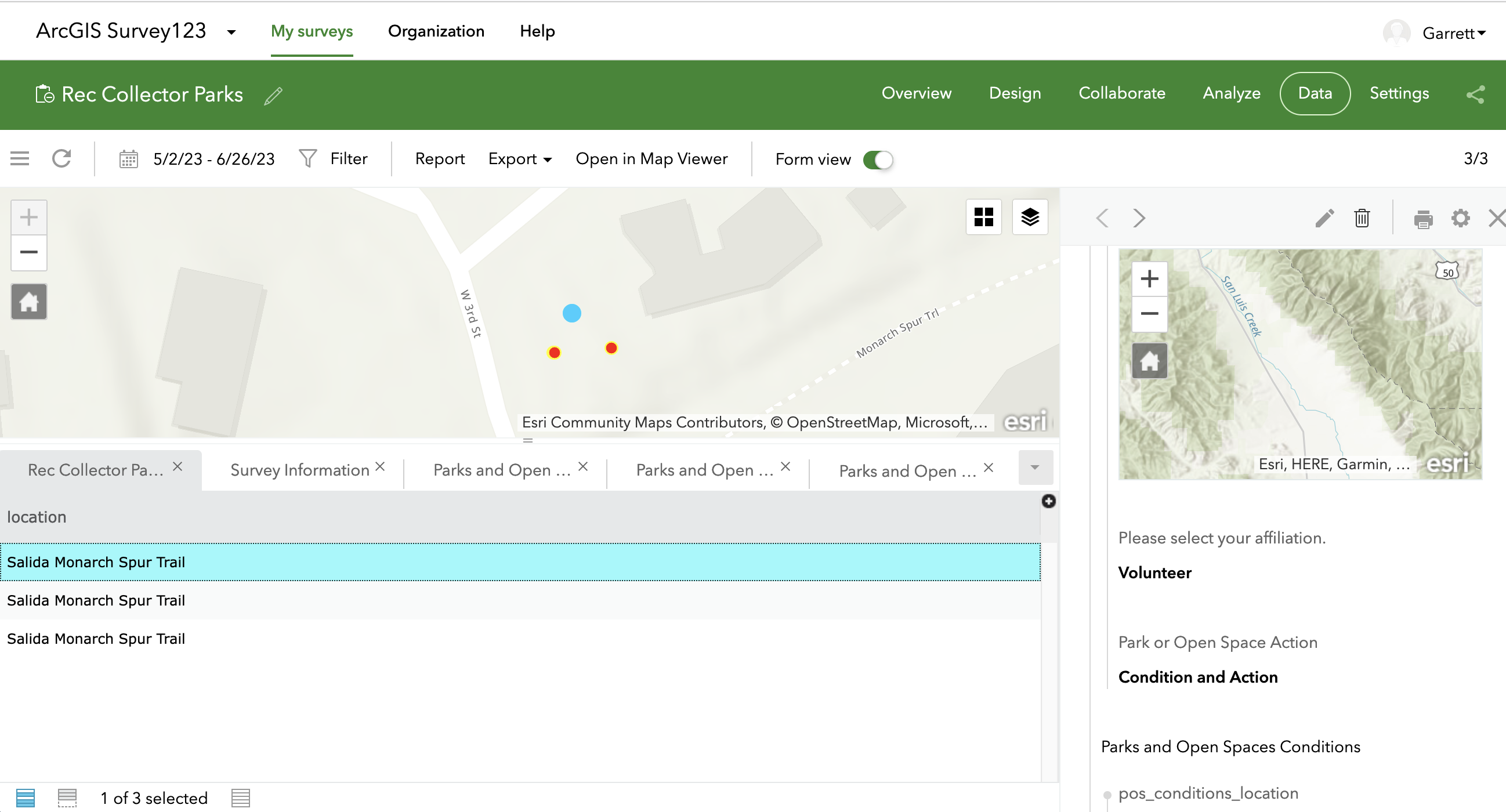

The first repeat, pos_information, includes a geo point question because the users want to know exactly where, within the polygon, that the survey was taken. I am trying to figure out how the forms are related to that particular point. When I open the test data on survey123.arcgis.com I can see that the point feature layer and the other repeats are linked to one another. However, when I open the data in ArcGIS Online I am not sure how to relate the table(s) to the point(s). I would like to create a hosted view of the points with the forms via MapViewer Classic.
Upon further reflection I do not think that I designed this properly because the park or open space name would not be unique if multiple points are collected within the same park or open space polygon. So, I would like to include the points collected via the geo point question on the FieldMaps map so that records for the same points can be collected over time. I can create specific pop-ups for these feature layers. However, for the original data, should I create a field in each of the repeats that uses the GlobalID created via the original point feature layer and if so, how would I do this?

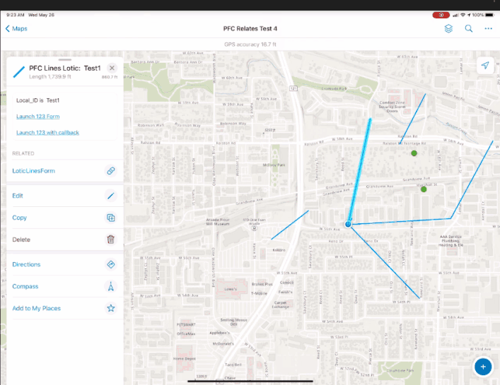

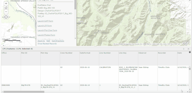

Hard to explain but here is it working where we have pre populated geometry that passes a key to the form.  Then on form save it auto flips back to field maps
Hope that makes more sense
Then in the map I can link to any form from the main point.
