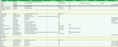

Below is the xlsx for one of the forms that does not function when I try to populate the SiteName field. I removed just the "begin repeat" and "end repeat" rows and the full url link worked, but would really like to make this a repeat. I also tried making the ${SiteName} type "note", "select_one", and "text", but that didn't fix the issue.
Sorry it's just a snip image, wasn't sure how/if I could attach it.
