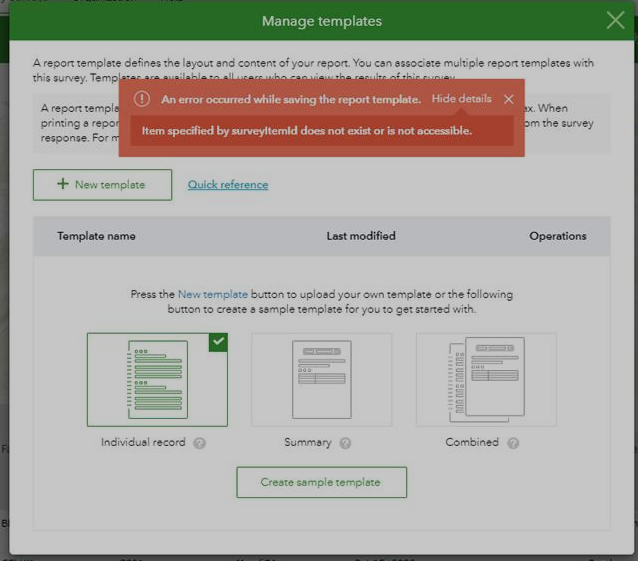

Since late yesterday I have come across something weird when wanting to create or upload a report template to a survey in ArcGIS Online. I get the error you see below. The survey works perfectly in every other way, but it is only the report that is causing an issue
It says "Item specified by surveyItemId does not exist or is not accessible.
What is this surveyItemId that is spoken about? How can it not exist?

Hi all,
Thanks all for raising the issue, we are sorry for the inconvenience. With the info provided by Matt, we are able to identify the cause for this issue now, and we will have this fixed in the upcoming hotfix.
If it is possible, could you please share your XLSForm that leads to this error? Then, we can test the fix more thoroughly. If you are not able to provide the form, could you please let us know is there an external choice question included in your survey?
