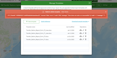

Since late yesterday I have come across something weird when wanting to create or upload a report template to a survey in ArcGIS Online. I get the error you see below. The survey works perfectly in every other way, but it is only the report that is causing an issue
It says "Item specified by surveyItemId does not exist or is not accessible.
What is this surveyItemId that is spoken about? How can it not exist?

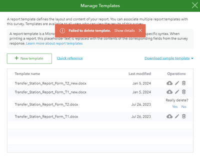

Failing to update or delete older version of report in Survey 123.  Any ideas why this happens?
I am able to add the new report separately with a different file name, but I can't delete the older version.
I would love to just update the older version.  I have tried to update the older version with the newer version using the same name as the older version.  It just fails to add.
