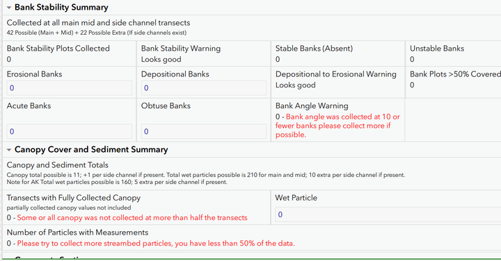

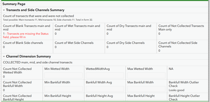

I can't but here are some shots

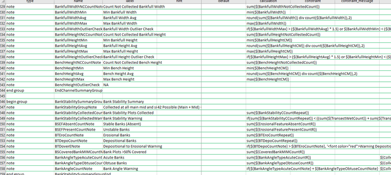

Calcs
Basically have a if(some condition, 1, 0) inside the repeat to get a number for a condition you are looking for.
Summary page outside the repeat use sum() for a total or, sum() div count() for an avg.  Or a join() just for display.
If you have nested repeats then do the sum twice.  Once in the grandchild, then again in the child and finally in the parent.  This will roll up the values.
Then you can use grid to make a nice display.  Plus add red warnings if anything is off.

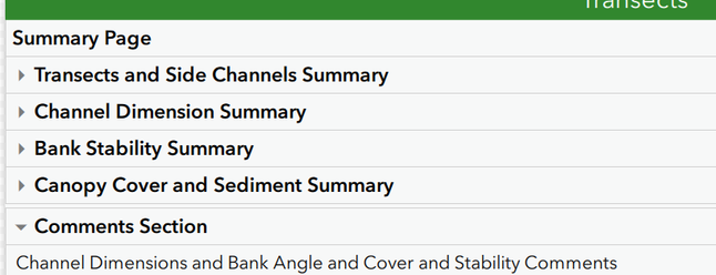

Expanded
Hope that makes sense
