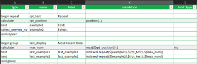

Here is one possible method. This is dependent upon data types.
Here is a slightly different take on it using indexed-repeat. You can probably use a Script to do this and add the data into the repeat (indexed-repeat on its own will result in a circular reference).
