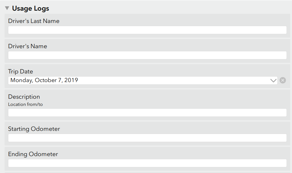

I'm working on a vehicle usage log for Survey123 that our field crews can track mileage for their vehicles.  Within a repeat group, I have fields of Starting Odometer and Ending Odometer.  Is it possible to auto-populate the Starting Odometer field based on the previous Ending Odometer record within the repeat?

I do this.
Create a field outside the repeat with a max on it and you will get the last value since you know it is the largest
max(${GapEnd})
Then in your repeat grab the max using once so that it does not change on you if they go backwards to view or edit.
once(${maxGapEnd})

MattCobb
Doug Browning‌ this is brilliant, worked perfectly.  Thanks a ton!
