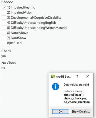

In this case, I recommend that you create one field that evaluates whether the user has selected a "known" answer, then another field to evaluate whether they have selected an "unknown" answer.
Once you have those fields evaluating correctly, set your constraint based on whether they have selected both a "known" and an "unknown".

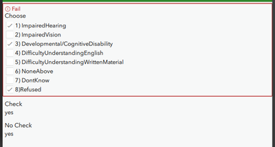

I have attached a working example of this below.

You could do this in a single field by using a calculation similar to:
not ((selected(.,'ImpairedHearing') or selected(.,'ImpairedVision')) and (selected(., 'NoneAbove) or selected(.,'DontKnow')))
