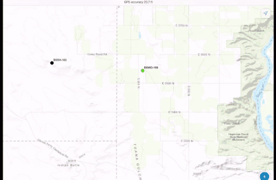

Looks like this.  I have 9 diff forms that are related so a bit more complicated but same concept.
In Field Maps

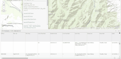

 In the web map
 Hope that helps.  Mock it up and see.
