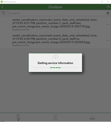

@DavidSolari  Thank you for the details. I don't think it's working. I attached another form2 and the screenshot. survey app keep loading nonstop when it was submit.
DavidSolari
MVP Regular Contributor
The hidden geopoint should be a distinct question, then a separate question has the pulldata call to extract whatever info you need. Note that if you're trying to get the polygon data from the parks to use as your form's spatial data, you'll also have to bind the hidden geopoint to the "null" esri type, otherwise you'll get errors due to the multiple spatial questions.
