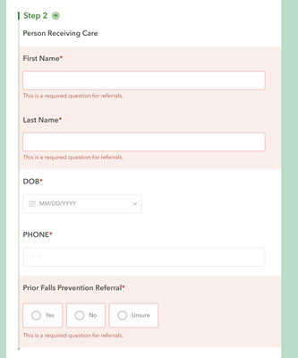

I'm also noticing my required messages are showing before anyone has had a chance to answer the question. Like as soon as relevant or esri:visible is true. And it's announcing them as survey errors at the top when a new conditional required question is shown, especially when navigating page to page.
I'm sure I'll ask someone to put an esri ticket in for me, but figured I'd start here.
Attached is my XLM form (service urls removed). Is there something I'm doing wrong between the required, relevant, esri:visible fields? Like some rule I don't know about? Like esri:visible and required don't mix? I have multi level groups and pages and maybe there's something I'm missing. I'm using esri:visible because there are some questions that I need to calculate even when their not relevant.
Pictured is right after I got to this page (page 2 of 2), automatically showing errors:
That seems weird! Like, sure once I click submit for this page, show the errors.. but not before???

And here's an example of how sometimes the requirement statements appear automatically when a requirement condition is met and sometimes it doesn't. All five of these questions have conditional requirements and statements. These should only appear if someone tries to submit or click next on the page and they are not filled out yet.

That is really just a "visual eccentricity" as everything is "working as intended".
In the case of "Last Name" and "DOB", both questions are still required, and both questions must be filled in prior to the form sending. If you try and press the send button now, "DOB" will also be highlighted red. And in either case, adding a response to one of the red highlighted fields will remove that highlighting.
The only thing you can really do is make a post in the Ideas thread, and/or call Esri and open a case to log a bug.
Teresa_Blader
Right, my issue here isn't that the messages appear at some point, but when they appear. An error message at the top shouldn't appear until "Submit" or "Next" is clicked. Showing up before distracts the user and introduces confusion. Whether it's a constraint message or a required message, both were designed to alert the user after a question is incorrectly interacted with or "Submit" or "Next" is clicked - not before. To say "hey you missed this or got it wrong" not "in case you were thinking about skipping this question or entering it in wrong, don't". The red asterisk is all that should appear until the "Submit" or "Next" button is clicked.
Normal functioning surveys behave this way. Alerting the user after a miss or incorrect formatting, not before. Yes, interacting with the question removes the response, but for some reason the conditional statements I have in esri:visible is interfering with the behaviors. I've opened a support ticket with Esri and will hopefully get to the bottom of it!
