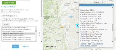

Here is some sample code for you using 1 layer.  You can make several arcade expressions and pass all of them over.  (note current bug requires all fields to be returned.
var sql = "PointID = '" + $feature.PointID + "'";
var tbl = Filter(FeatureSetByName($map,"Points", ["*"], false), sql);
return First(tbl).DesignLat
arcgis-survey123://?itemID=2fb3880b8631451cac08f1653f350787&field:PointID={PointID}&field:EvaluationID={expression/expr0}&field:FieldEvalDate={FieldEvalDate}&field:FieldEvalStatus={FieldEvalStatus}&field:DesignLat={expression/expr6}&field:DesignLong={expression/expr7}&field:AvgTypicalBankfullWidths={expression/expr1}&field:CollectCoreSubset1={expression/expr8}&field:CollectCoreSubset2={expression/expr9}&field:CollectCoreSubset3={expression/expr10}&field:Supplementals={expression/expr11}&field:CollectGreenlineVegComp={expression/expr12}

&field:EvaluationID={expression/expr0} is to pass a value from Arcade
&field:PointID={PointID} is to pass a field from Collector or Field Maps.

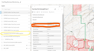

I have been searching the community for weeks now looking for ideas and I think you maybe speaking to what I need to do. Let me run what I'm trying to get past you.
I'm using offline map and survey. I have a popup in layer A (the selected layer) with URL using callup fields of the feature in layer A the user has interacted with (pushed on) to populate in the survey.
What I am hoping to add to this URL, is a way to also callup a field in Layer D (circle in yellow) of the feature with the matching attribute X (in orange) from the feature selected, thus returning a value from a different layer in the same map which shares a common value  to the feature selected.
My idea was something like:
Field X = (in layer ID reference feature with field Y matching field Y {return value to populate}
&field:DateCompleted=(id=0cf6839995f34aafb01a5459d7f6205d,(SUID=SUID){DATE_COMPLETED})
I feel like I'm note even explaining this right
