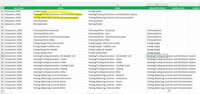

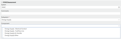

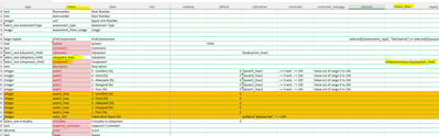

Choice filter in survey 123 connect only applying on some not all choice filter.
425
02-26-2025 01:33 PM
AudraPayne1
choice filter showing up for some options but not others

Wouldn't the subsystem choice have to be 'Heating' to show the heating/cooling list?
I think your subsystemchoice list (not shown I don't think) needs to be changed to include 'Heating' instead of Heating / Cooling generation and distro system or vice versa.

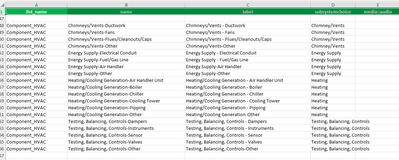

AudraPayne1
I think this is what you were saying, but maybe opposite? This worked though! I just copied the exact cell from the list that I highlighted and updated those subystemchoice values. Thank you for the guidance!
