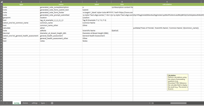

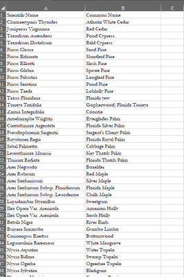

AustinGootee
Thank you Survey123 Connect was definitely the way to go, I tried updating the code online with the extra parathesis and it still wasn't working. Now i just need to do some technical work to get the surveys to save onto our server and not the local machine, so anyone can access their designs, but that's a task for another day.
As for the survey 123 connect and the csv tables, I was able to add the table and utilize it to fill in the scientific name based on a drop down list of common names (previously created online). Is there a way for me to use the common name field in the csv file that I added to create a drop down list, instead of having to fill in the choices sheet in the survey's excel file?
Katie_Clark
MVP Regular Contributor
Yup! I recommend reading this post about external choice lists
