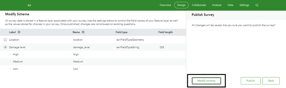

For the values in dropdown lists, what you see is expected because when data is exported from ArcGIS to a non-Esri format such as Excel, CSV, etc, the value that gets exported is not the label of the dropdown but the code.  At this time, you should be able to do a find & replace in your data to get your labels back.  In the future, when you are designing your survey, you could use the Modify Schema option in the web designer to specify in advance what code (name) you want for your list values.  The Modify Schema option is only available before you publish your survey.
