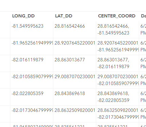

I have a working link that pass attribute values (including center location, I pre-calculated the WGS84 latitude, longitude, and lat-long pairing fields ) from Field Maps to Survey123 app:
arcgis-survey123://?itemID=1d71b9c869c44a27a68d10115bd3aa54&center={CENTER_COORD} &field:meter_number={meter_number} &field:account_number={account_number} &field:sub_code={SUB_CODE} &field:feeder_number={FEEDER} &field:circuit_id={circuit_id1} &field:county={BI_CNTY_CD} &field:board_district={BI_BOARD_DIST_CD} &field:service_status={status} &field:last_name={BI_LNAME} &field:first_name={BI_FNAME} &field:phone_home={HomePhone} &field:phone_mobile={MobilePhone} &field:phone_business={BusinessPhone} &field:phone_other={OtherPhone} &field:email_the_member={Email} &field:service_address_1={BI_ADDR1} &field:service_address_2={BI_ADDR2} &field:service_city={BI_CITY} &field:service_state_name={BI_ST} &field:service_zip_code={BI_ZIP} &field:bill_address_1={BILL_ADDR1} &field:bill_address_2={BILL_ADDR2} &field:bill_address_3={BILL_ADDR3} &field:bill_city={BILL_CITY} &field:bill_state_name={BILL_ST} &field:bill_zip_code={BILL_ZIP} &field:bill_cycle_code={BI_CYC_CD} &field:bill_route_code={BI_ROUTE_CD}

My link works good in passing the attribute information to pre-populate the survey except for the center of the point, it keeps on putting the location at 0,0 lat-long. I read that for web apps it is sensitive to commas/spaces, so I change my link to replace "center={CENTER_COORD}" with "center={LAT_DD}%2C{LONG_DD}" also tried "center={LAT_DD},{LONG_DD}", but when I launch the survey from the web application and finish it still put the point at 0,0 lat-long.
